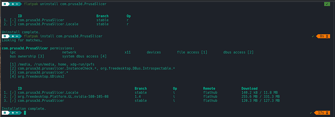

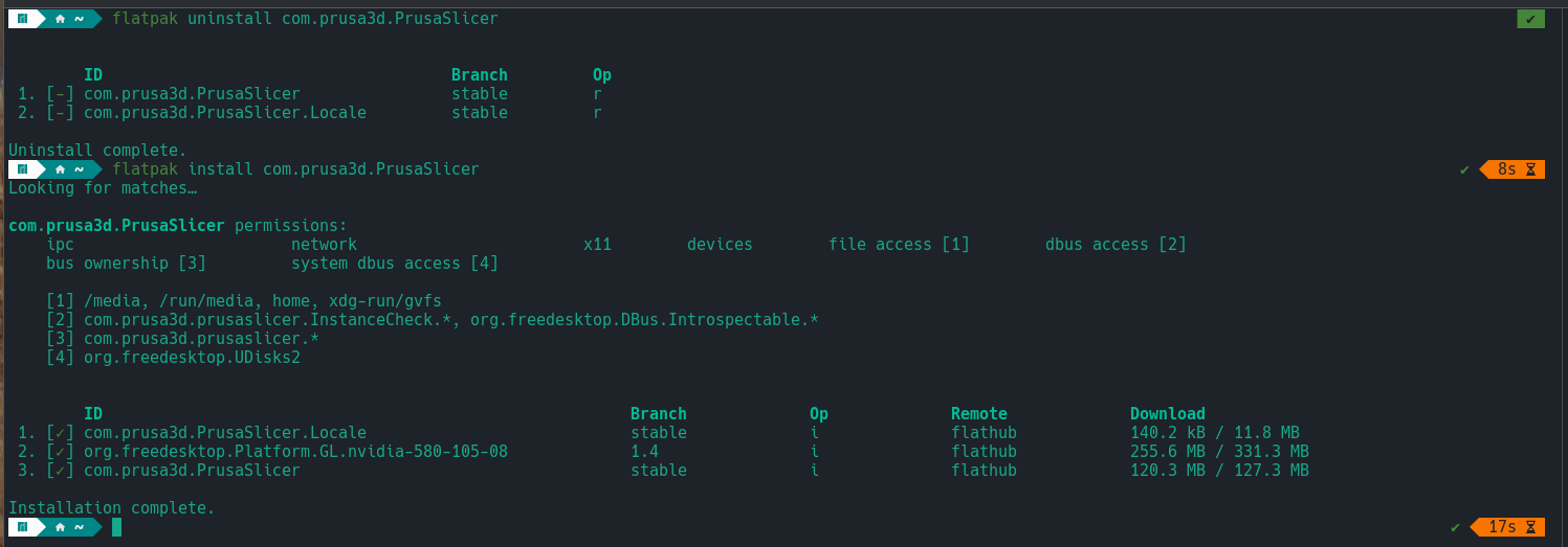

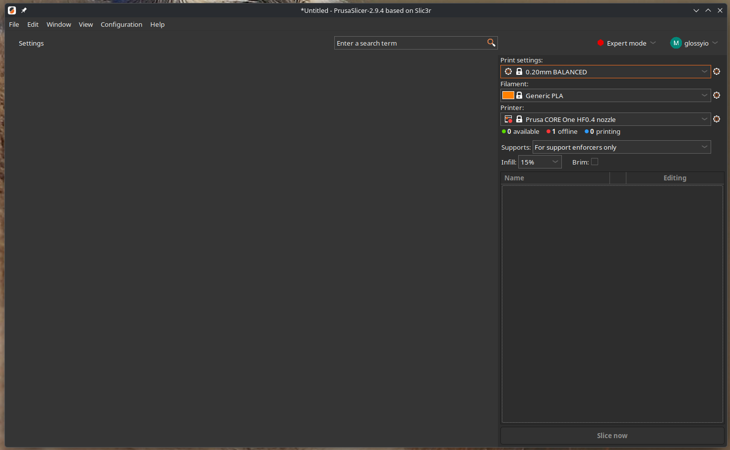

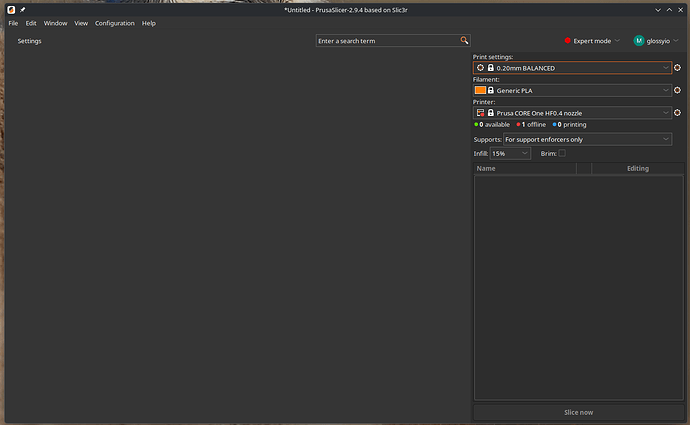

After the Manjaro update PrusaSlicer 2.9.4 (flatpak) no longer renders the main screen, though the menus look fine. It is a blank screen where the plate and objects would load, and when I try to load a previous model the program crashes. I have an AppImage of OrcaSlicer and that works fine.
Anything I should look for to correct it?
Ah, scratch that. I uninstalled and re-installed (per this issue) the PrusaSlicer flatpak and it worked. Must have been the nVidia driver…
Well, at least that rules out a local issue.
