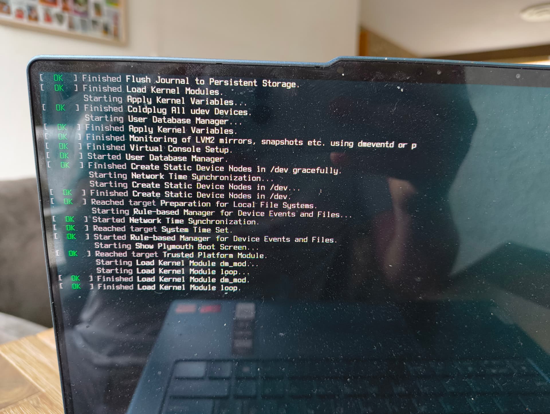

I tried booting with newly published iso images and Manjaro doesn’t even boot. This is a screen where everything hangs.
This screen just keeps refreshing and not progressing forward at all.
It might be my karma or this release is a bit troublesome
