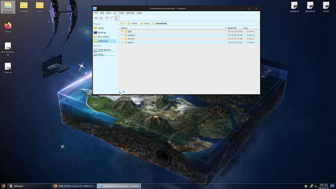

Dolphin shows limited Drive informations after update.
Check the mouse cursor.
The zoom slider, free space, how many files/folders are available in the current location.

I cannot confirm that. Works fine for me and shows all information while hovering over a file/folder

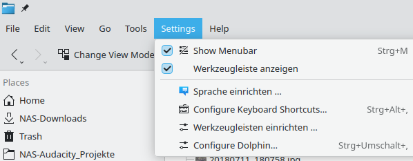

This behavior is configurable in the Dolphin Preference Dialog now:
Benutzeroberfläche → Status & Adressleisten → Status Bar → Full width

In English, you can find this by clicking the “hamburger” button, 3 vertical lines.
Configure-> configure Dolphin. Interface (default), the tab Status & Location bars. Full Width.
Thanks for the tip. I am always filling up disks, vital that I see diskspace free.

It looks like that this setting just had to reapplied in the Dolphin Preference, i had this all configured on KDE but the update introduced this minor bug.
Thanks i could fix it with reapply Full width in Settings>Configure Dolphin>Interface>Status & Location Bars.

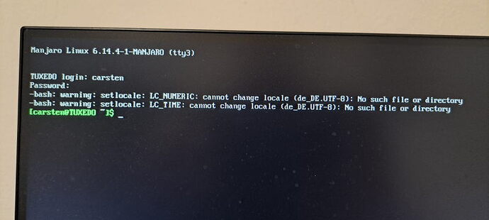

I have a language issue after the update:
Menue entries are mixed in german and english
here an example with dolphin:
MixedMenue
LibreOffice cannot open a file with “ä, ö, ü”…
Here an example with the file “Frühlingsknospen”:
LibreOfficeUmlaute
When I log into console, then bash reports this one:

perl: warning: Setting locale failed.
perl: warning: Please check that your locale settings:
        LANGUAGE = "",
        LC_ALL = (unset),
        LC_CTYPE = (unset),
        LC_NUMERIC = "de_DE.UTF-8",
        LC_COLLATE = (unset),
        LC_TIME = "de_DE.UTF-8",
        LC_MESSAGES = (unset),
        LC_MONETARY = "de_DE.UTF-8",
        LC_ADDRESS = "de_DE.UTF-8",
        LC_IDENTIFICATION = "de_DE.UTF-8",
        LC_MEASUREMENT = "de_DE.UTF-8",
        LC_PAPER = "de_DE.UTF-8",
        LC_TELEPHONE = "de_DE.UTF-8",
        LC_NAME = "de_DE.UTF-8",
        LANG = "de_DE.UTF-8"
    are supported and installed on your system.
perl: warning: Falling back to the standard locale ("C").

Now, I restored my system with timeshift and language works fine.
After the update the language was wrong again.
Now I see that in the Manjaro-Settings-Manager was no entry for any language. I added german there and after a restart all language problems are solved.
