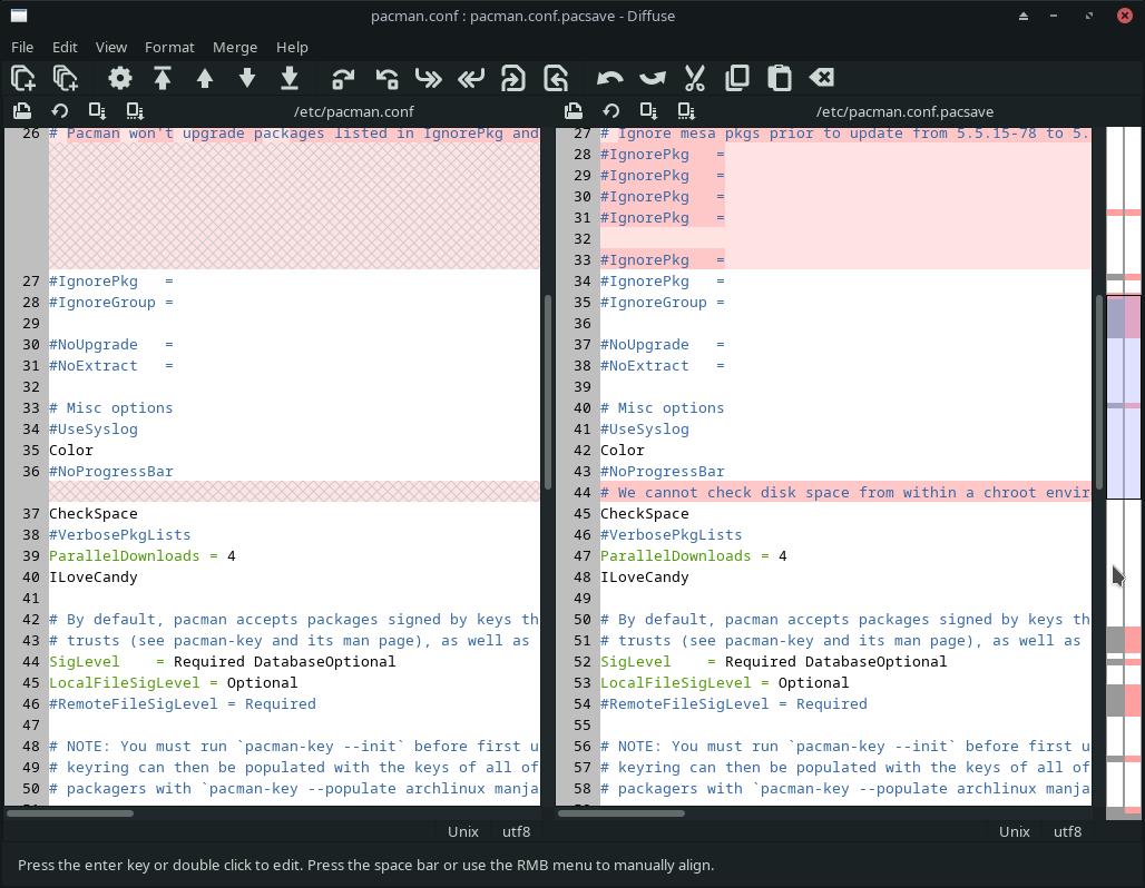

Please use a more comfortable comparison tool then⌠ex: meld;
DIFFPROG=meld pacdiff -s
Its usually a good idea to have these environment variables set, such as in /etc/environment ⌠which would make the preceding environment variable unnecessary.

I have also updated the guide post with more verbose pacdiff instructions included, namely the env var things and some explanation.

Finally i had the idea to manually open the pacman.conf and pacman.conf.pacnew - files in the texteditor, and here are my main questions because i have no idea what i am doing:
the main differences are
pacman.conf:
CacheDir = /var/cache/pacman/pkg/
#UseDelta = 0.7 --- this line is not in pacnew
#Color
#ParallelDownloads = 5
# REPOSITORIES
[core]
SigLevel = PackageRequired
Include = /etc/pacman.d/mirrorlist
[extra]
[community]
[multilib]
pacman.conf.pacnew:
#CacheDir = /var/cache/pacman/pkg/ --- is now commented out for some reason?
Color --- was commented out in pacman
ParallelDownloads = 4 --- was commented out in pacman and figure was 5
ILoveCandy --- is a totally new line?
# REPOSITORIES
[core]
[extra]
[multilib]
---- Here in [core/extra/multilib] the lines with âSigLevel = PackageRequiredâ are not included anymore ??? - Are they needed?
Is this alright?
do i need to change anything in these two conf-files with my texteditor?
i do not even know if i have to copy lines from pacman.conf to .pacnew, or from .pacnew to pacman.conf
do they have to have the exact same values?
many thanks for your help!
To sum up: You can safely overwrite. The only important change it the community repo, and you want that. Just type pacdiff in terminal and when it comes to pacman.conf hit overwrite with the new one (i donât know if you have other pacnew files, cannot comment on that)
