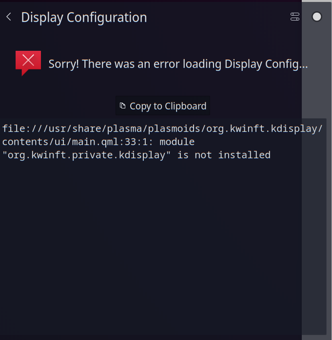

My Display configuration module isn’t loaded anymyore by KDE:
file:///usr/share/plasma/plasmoids/org.kwinft.kdisplay/contents/ui/main.qml:33:1: module “org.kwinft.private.kdisplay” is not installed
when starting kdisplay directly, I get this:
EDIT: fixed by installing kdisplay-git @nunonun

I did the update yesterday, and today when I restarted the computer, I realised that my external monitor is not positioned as it used to be. I went to System Settings > Display and Monitor > Displays to try to reconfigure it, but instead of the usual panel, I get to see the following error message:
I’ve tried to reinstall kdisplay and disman, but it doesn’t solve the problem. I suppose these are important modules, no? Or can I remove them, as suggested by the error message?
