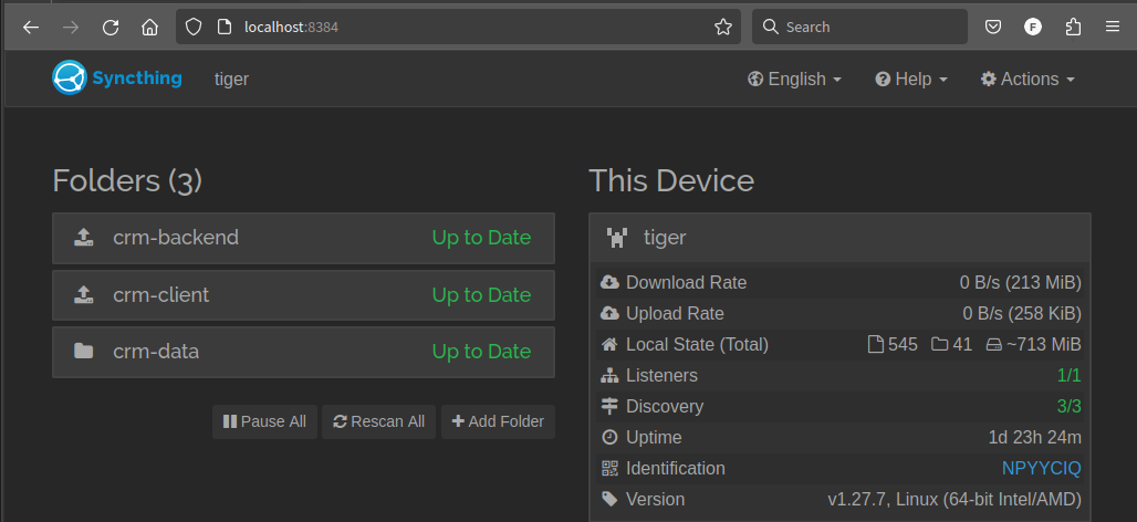

There is no sensitive info exposed ... the rare occasion justifying a screenshot
Wait a moment - that means the service is running … no matter the port …
I can’t guess how it might have happened, but it seems like Syncthing is listening to a typical loopback address used for a webserver. Do you you have a local webserver active?
localhost:8384 is the default port that Syncthing should use.
