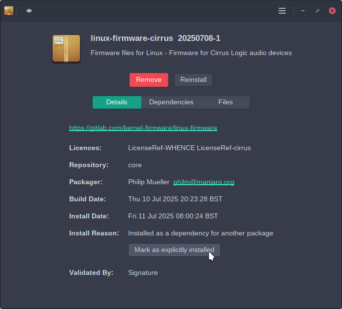

Pamac GUI has a button to mark a package as explicitly installed

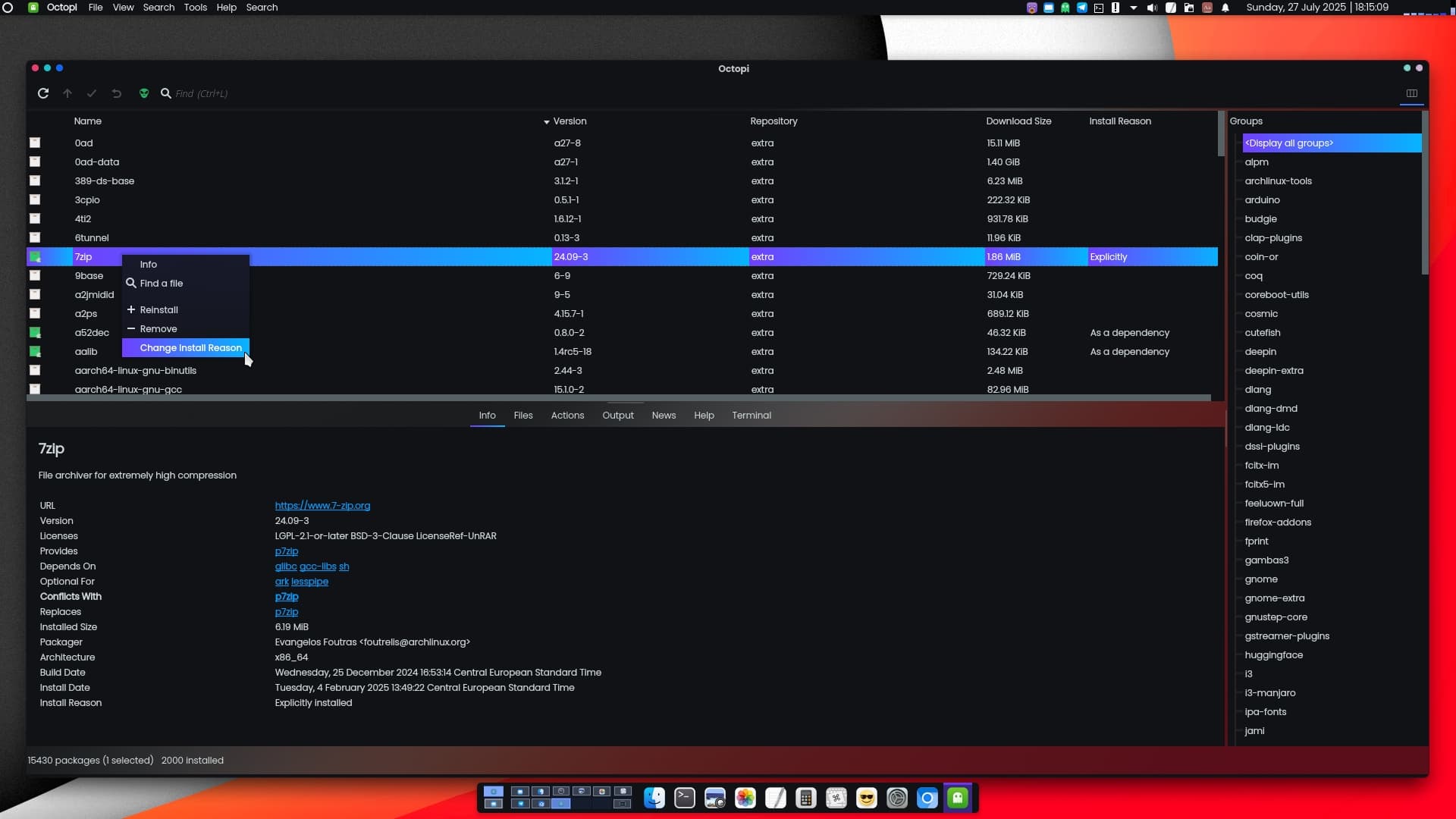

For that matter, octopi also has the option to change the install reason.
