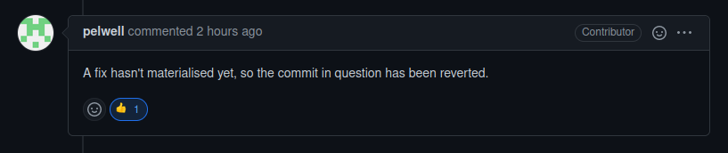

I’m still patching. This has been a long process with this issue; been going on for 2 weeks. They have narrowed down my patch some to address the issue but they still are not done anything yet on their side. Their last post said “A revert is likely, unless we find a fix first.”

As of today RPi has reverted their commit so with the future kernels I will not have to patch them.

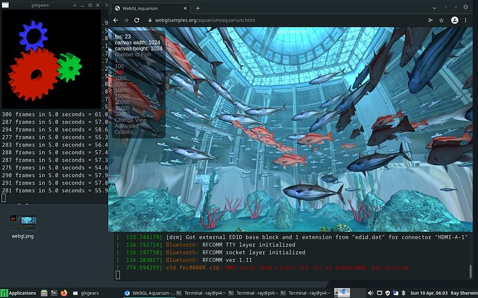

They have done a hack to get V3D working but they say it still is not right. The author anholt says he gets an OOM at @hour on his board. I have been running the webgl aquarium page and glxgears for about an hour and so far I have one instance of v3d fec00000.v3d: MMU error from client L2T (0) at 0x78a1000, pte invalid he mentioned in his commit on my pi4 8G ram board but it has not affected any performance or caused any other issues so far. I believe I will let the webgl page run for another hour and if no issues pop up I will push the kernel 5.18-rc1 to the unstable repo.
https://github.com/raspberrypi/linux/commit/70388f2326a06d9eef3fe525561d8a03f4206f66
Well I got off on another project and forgot about the 5.18-rc1 kernel running the webgl test page so it has now been several hours and I still see no real issues with it so I have pushed the kernel to the unstable branch for others to test also when the mirrors sync.

My setup also threw the error but it went unnoticed from a desktop perspective:
[  186.974835] v3d fec00000.v3d: MMU error from client CLE (4) at 0xe621000, pte invalid
23 fps???
My setup only manages get 10 fps.
It does that in firefox. Did you try chromium?
With chromium I get 20+ fps, I feel better now. :slight_smile:
