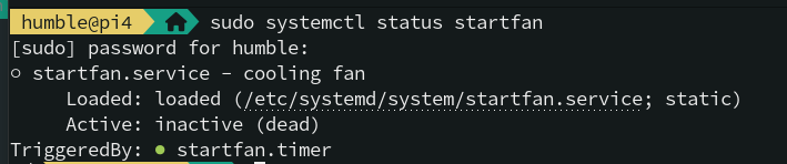

OK so this is kinda where I was at before.
Did a shutdown and powered back up and no fan.
I can start the fan in terminal
It hadn’t been triggered yet, I set it 1 minute to hopefully make sure the device was detected first.
By starting the service manually?
I didn’t try that - I did the echo command to usb
Ok so set it to pwm_0, if that works, and try the service, post any errors.
pwm_0 would be 0% fan speed.
Can I edit the timer to say 15 without the “Min” would that equate to 15 seconds?
I mean set it to 0 (or something low like 20, so you can see/hear the difference) then run sudo systemctl start startfan.service if it doesn’t start up again then run the command itself to turn the fan back on then post the output of systemctl status startfan.
You can change the timer, but we should get it working first.
!!!BOOOM!!!
I did shutdown and I have fan!
