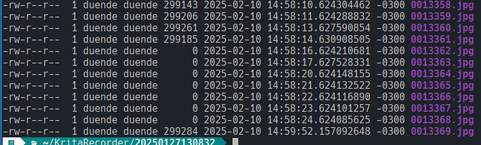

Or it should. Yesterday I ran into something new that may or may not be related, the crash made krita’s timelapse recorder (Which just saves a string of jpegs) save several 0 byte files, having 200 gb of space available. So either it messes up R/W or some component goes and locks the disk when it notices the cpu messing up. Will report if I see it happen again.

The non-empty file was from opening it after the crash. But what I get rom this that may actually be useful is it gives me a specific time when the crash started and the system entered a dead man walking status, and how long it took to become noticeable.
