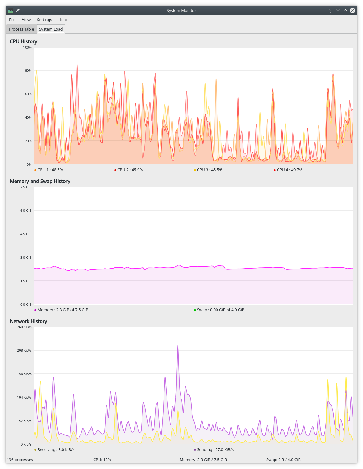

This is using a 1 minute sample so there are a few hours here. As you can see, I have yet to hit 3GB and I have memory set aside for nfs caching and use tmpfs quite a bit. So while Plasmashell does use a bit more memory as the day goes along, it is not much. Not enough to make a noticeable difference, it never gets beyond the normal ups and downs of total memory used.
