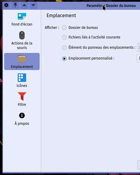

German desktop here, so the names may vary.
Can you check whether the correct path is listed under System Settings > System > Session > Locations/Places/or similar > Workspace Folders?
First, back up the contents. Does it help if you enter a different folder there, does it then work? Or does it work if you switch back from the other folder to the original one?
Here is the french access to the settings I explained:

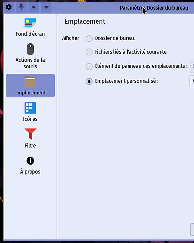

Found a workaround:
In the desktop settings, I manually set the folder path to /home/user/Desktop/ as in the screenshot.
If I select from the file dialog picker, it automatically sets desktop:/ but that doesn’t work. Had to overwrite the text entry with /home/user/Desktop/.
Custom settings screenshot

Settings switched back to “desktop folder” aka desktop:/ after logging out/in again. Had to revert manually settings as icons weren’t updating again. Workaround is not workaround if you have to do it every single time you log in.
