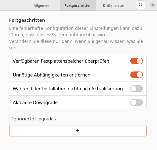

In pamac, check preferences-Advanced Tab-Ignored Upgrades
Thanks for your quick reply.
I checked the advanced tab, but they do not appear as ignored. Unfortunately that’s not the solution.
