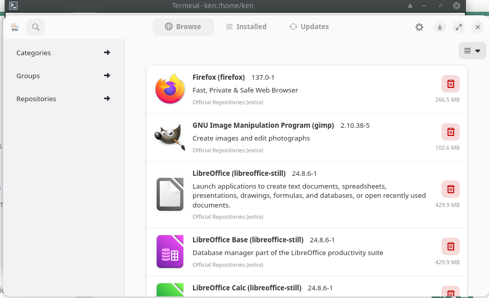

That’s not what my window looks like; I don’t have the 3 dots in the upper right corner.
But you do have access to the Settings somewhere.
The picture was not mine, btw - it’s probably what pamac-manager looks like in KDE/Plasma.
For me (Xfce4), the “three dots” are also at the top, but in vertical orientation and not at the far right, but farther in.

It’s pamac-gtk3, which for now is the recommended pamac-manager GUI for Plasma systems. Xfce and GNOME use pamac-gtk, which is gtk4-based. :wink:
Also, the three dots — for bringing up the settings menu — are in the upper right corner of the window in my user account because I have my window control buttons on the left, as in macOS.
I had pamac-gtk3 installed, so I installed pamac-gtk instead (since I’m on Xfce). Still no 3 dots anywhere, but I no longer get the gtk3-critial messages.

2025-04-08_18-24-1
I thought this might be a theme issue, so I started pamac-tray as
GTK_THEME=matcha-dark-sea pamac-tray &
Results were:
I had previously set the xfce theme to the same, as can be seen by the top of the terminal window above pamac.
The gear icon should open the settings, if that’s what you’re looking for.
You do have some way to access the settings, no?
… probably the gear icon as @dmt said …
This is what it looks like with the “really” default theme:
https://0x0.st/8_Y4.png
You can see the “three dots” fourth place from the right?
I didn’t execute:
which got me nothing at all, btw …

I see the dots in your png file, but it seems that no matter what I try, I can’t see them. I set the xcfe4 theme to matcha-sea, no change.
grep Refresh /etc/pamac.conf
RefreshPeriod = 24
I tried GTK_THEME=matcha-sea pamac-tray &
and the window title bar is now gray (when focussed), but still no 3 dots.
… and you have no access to the settings?
… through the gear icon, presumably? (in your screenshot)
