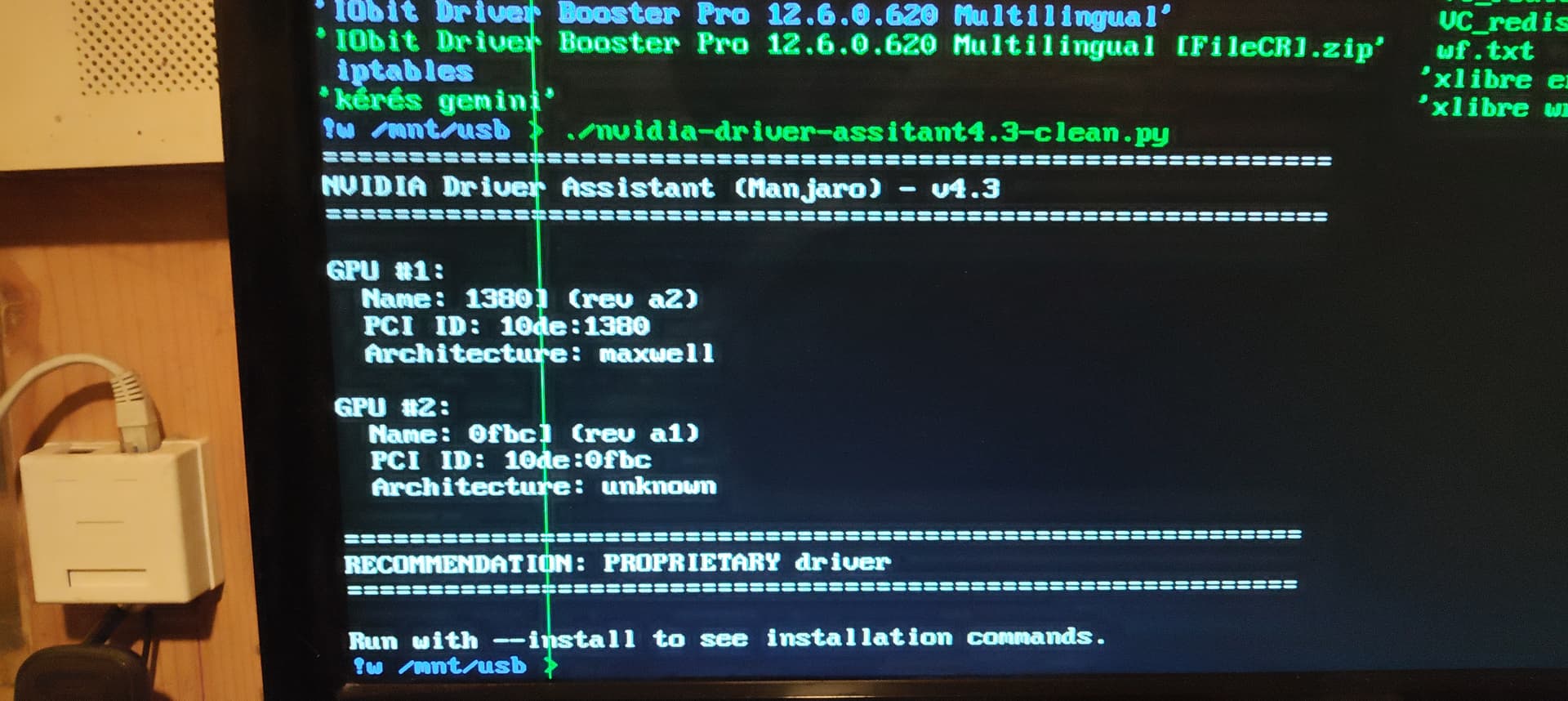

This is just for fun… for the logic…
detecting without anything… this is in the v4.3clean branch.
(dont ask about the green line please):slight_smile:

Well I now checked the older database of 0.22.105.08-1 and I got this:
{"devid":"0x1380","name":"NVIDIA GeForce GTX 750 Ti","features":["hdmi4k","vdpaufeaturesetE"]}
python ./nvidia-driver-assistant --simulate-gpu 750 --verbose --supported-gpus 0.22.105.08-1/usr/share/nvidia-driver-assistant/supported-gpus/supported-gpus.json

So it seems the database update went wrong by upstream Nvidia somehow: https://gitlab.manjaro.org/-/snippets/1178/raw/master/nvidia-db-update-0.23.48.01-1.txt

OK, I hope I fixed it for now via revision 5:
DEBUG:root:get_nvidia_devices(): Processing Vendor: 10DE, Device ID: 0x1380, class 0x0300
DEBUG:root:pci:v000010DEd00001380sv000010DEsd000018FEbc03sc00i00
DEBUG:root:Device: has following feature: hdmi4k
DEBUG:root:Device: has following feature: vdpaufeaturesete
DEBUG:root:Device: has following flags: []
DEBUG:root:Device: needs proprietary driver
DEBUG:root:gpu.get(legacybranch): NVIDIA GeForce GTX 750 Ti belongs to legacybranch = 580.xx
Detected GPUs:
  NVIDIA GeForce GTX 750 Ti - (pci_id 0x1380)
DEBUG:root:recommend_driver(): Do device IDs support the open driver?
DEBUG:root:recommend_driver(): using json logic
DEBUG:root:recommend_driver(): all devices require closed
DEBUG:root:Recommended driver: closed
DEBUG:root:get_distro(): detected manjaro  distribution is supported
Detected system:
  Manjaro Linux
DEBUG:root:OS detected: manjaro
DEBUG:root:get_legacy_branch(): NVIDIA GeForce GTX 750 Ti belongs to legacybranch = 580.xx
Please copy and paste the following command to install the legacy kernel module flavour:
  sudo pacman -S linux618-nvidia-580xx
I just tested it, and i can confirm -5 is detecting correctly, showing that you know what you doing :slight_smile:
