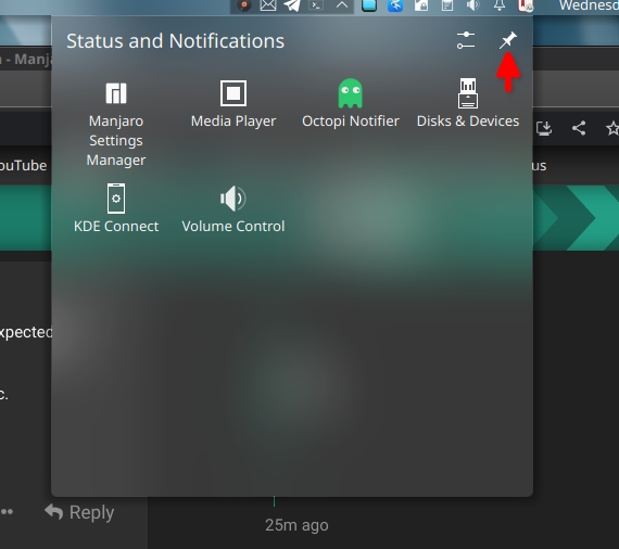

That is the normal behavior. However, if you have the pin pressed in… :arrow_down:
… then it’ll stay open.
OMG i completelty forget about the pin! :person_facepalming:
Unfortunatly because of my theme its just a round circle so you can’t see the status.
Thanks a lot :wink:
