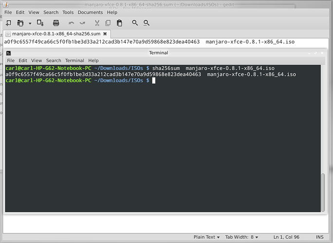

If you checked the ISO and you properly made the USB live media, there should be no issue.
