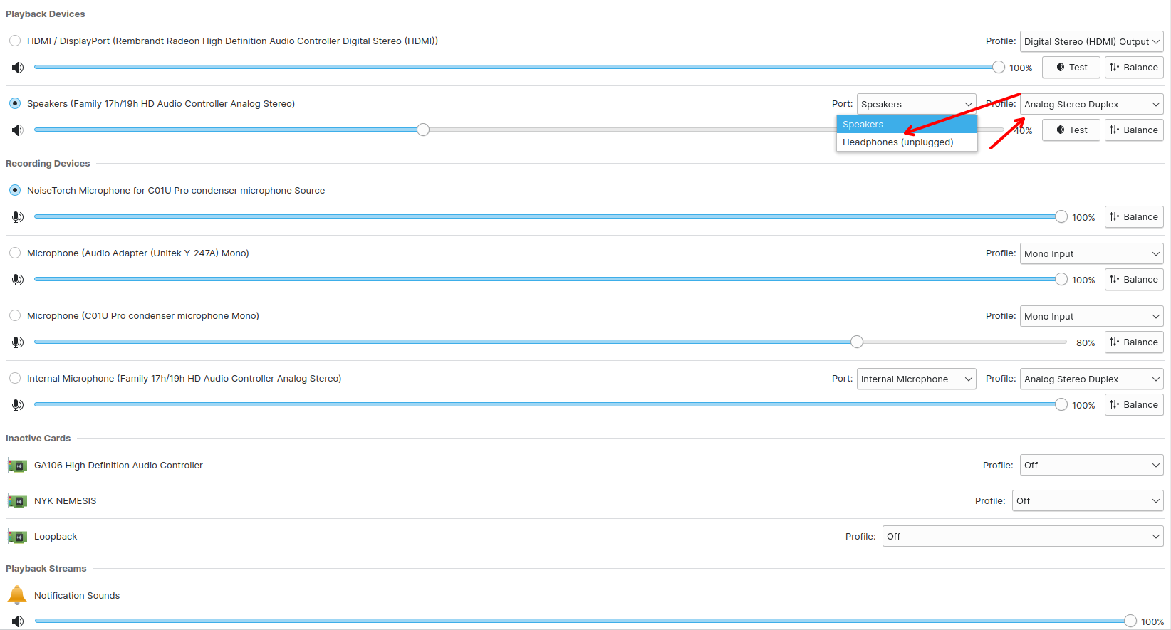

Since you’re using KDE, please screenshot the Audio section of system settings. At least we can see which card is using which profile opening which port.

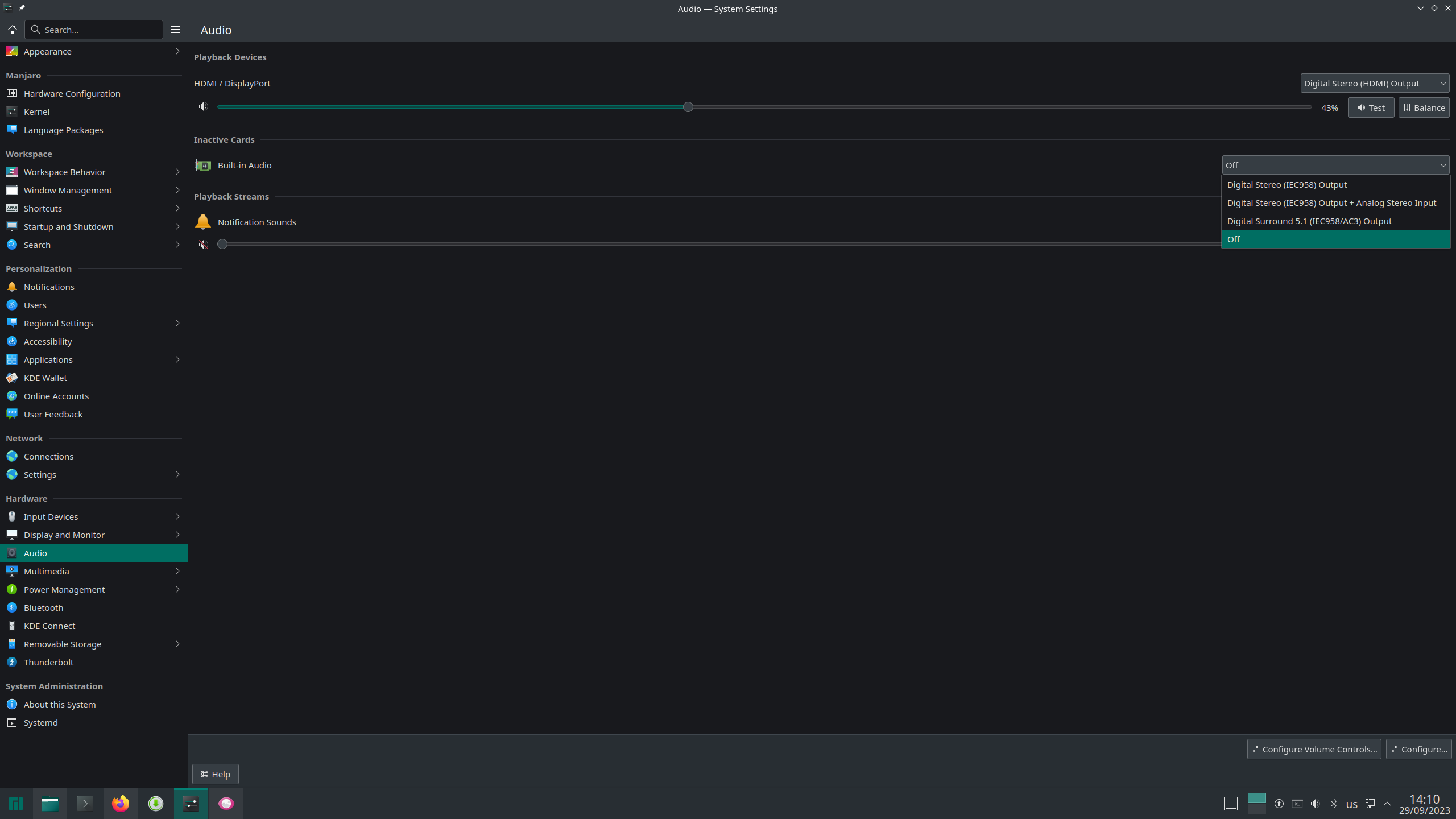

OK, this shows that you only have audio through HDMI and a built-in card which is currently inactive. I think you really need to open the case and check the wiring, hopefully you still have both the motherboard and the case documentation.
JACK seldom causes issue. If ever, you won’t be able to hear audio from any port. The fact that the back one still works rules out the possibility of JACK interfering. However, I suggest to only use either PipeWire (which can emulate both PulseAudio and JACK) or PulseAudio and JACK (and make sure if you really need JACK in the first place, if not just PulseAudio then). This will minimize the chance for any to disrupt the routing in any way possible.
Anyway, back to your KDE audio settings, a typical audio jack enabled card should have this profile:
I’m using PipeWire, which is why it’s named like that. The PulseAudio equivalent is usually Built-in Analog Stereo, but the Profile and Port should be similar.

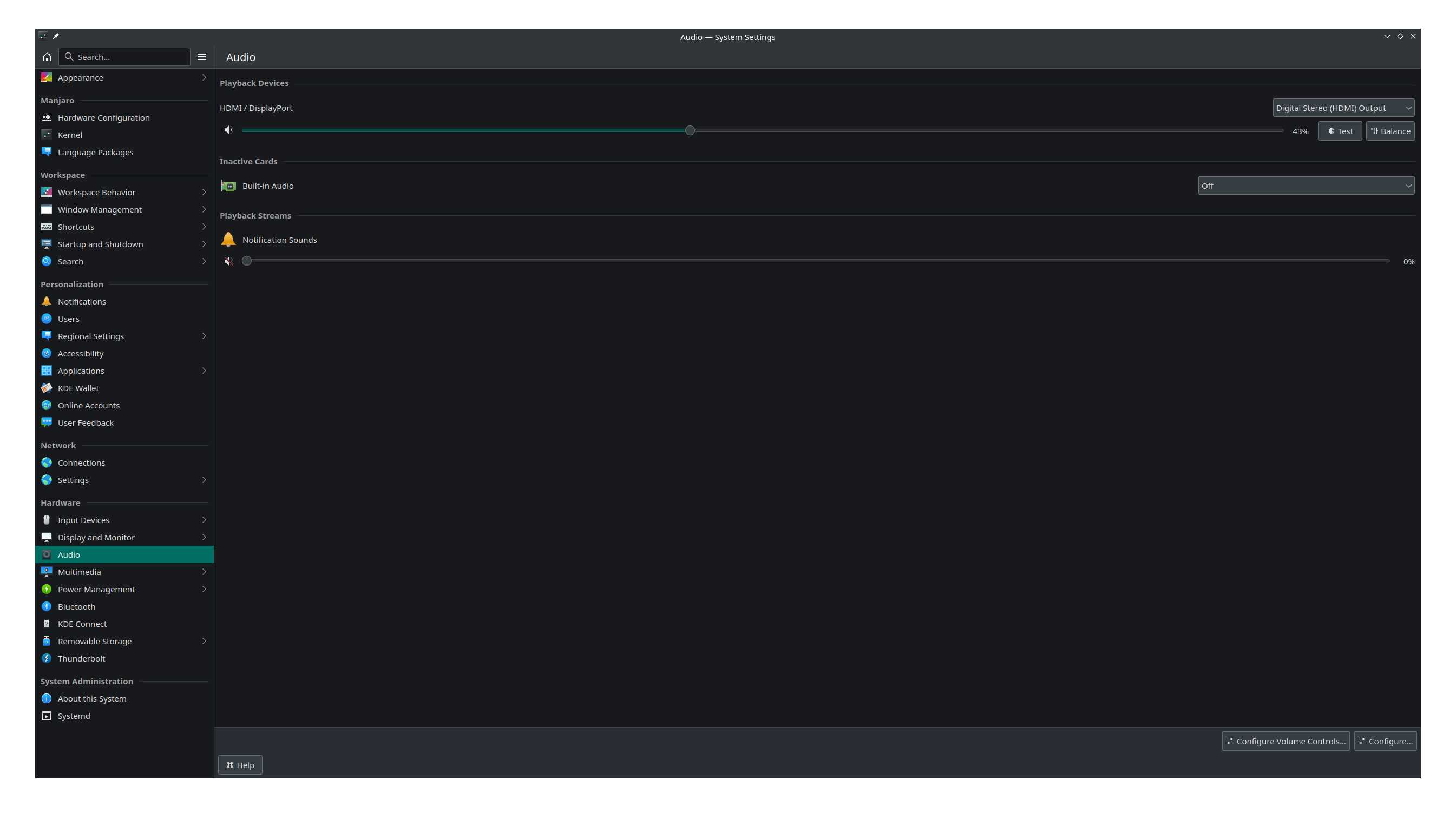

Do audio GUI controls show if headphones are plugged-in or unplugged?

GUI doesn’t show that the headphones are connected.
