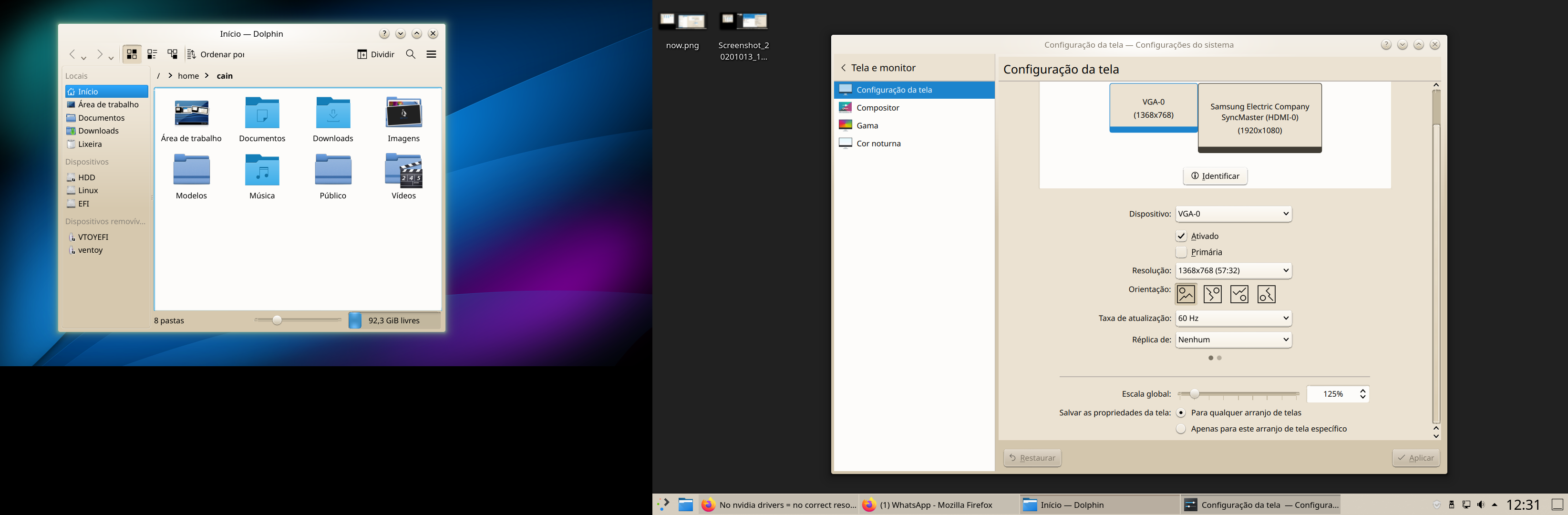

My primary monitor is a samsung P2270HN and my secondary monitor is a W1943C, when I install the Nvidia driver the secondary resolution is 1368x768 and it works perfectly … But it breaks the screen composition.

on my left (VGA-1)W1943C 18,5’’ 1360 x 768 (runs better on 1368x768) @ 60Hz h 30 ~ 61 kHz v 56 ~ 75 Hz
right in front of me (HDMI-1) P2270HN 1920x1080 @ 60
both 16:9
I’m currently using the free driver with the secondary monitor in a 4: 3 resolution so that it doesn’t blink
Will it only support 1368x768 with nvidia drivers?
Is there a way to save the resolution setting (modeset) of the nvidia driver and use it on the free drive?
How is workaround to solve the dpi problem you said?

The situation is as follows:
If I use Windows or Linux Mint Cinnamon with proprietary Nvidia drivers the Samsung monitor remains at 1920x1080 but the LG monitor on my left changes to 1368x768 (the native resolution).
At the moment I have 2 choices: Continue with the perfect screen composition but with the monitor on the left in a broken resolution (both of them looks horrible outside the native resolution), or install the proprietary Nvidia driver and leave my monitor at 1368x768 and break the KDE screen composition.
Using those settings to force the dpi partially solve the problem (but not completely and some things like the login screen are broken, resized icons is horrible too).
I’ve tried using addmode to try to put the monitor on the left at its native resolution(1024x768>1368x768), it didn’t work with free driver (the proprietary driver already goes automatically).

as in the image above, all elements start to flash and are badly sized.
The thing is… KDE with the noveau works flawlessly here! :drooling_face:
If I could save the timings / modeset used by the nvidia driver and use them just to keep the secondary monitor at its native resolution in the modeset-driver it would be very good.
