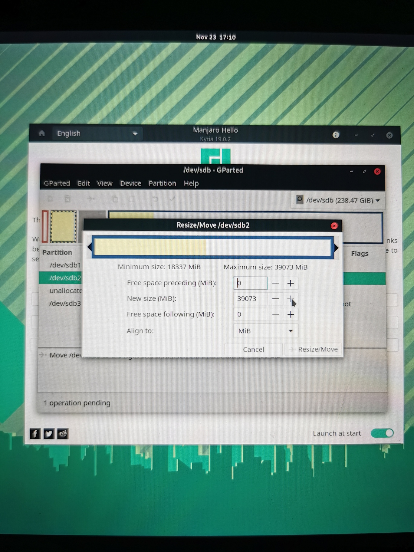

I am having a space issue as you can see in the picture i have only 736mb left. So i want to add more gb to the partition

I did it if you take a look at the operations pending.
I took 20gb from the big one.
Now i need to add the new space to sdb2.
How should I do that?
I have plenty of time :slight_smile:
If you can’t extend a partition to the left – because the file table is usually at the beginning of a partition – you can move it to the left then extend it to the right.
So is this the right way?
Looks good.
Aligning to sector should prevent small unallocations between partitions, although that’s not guaranteed.

Can i Apply and leave the 1mb unallocated?

I did it and worked perfect. No data loss.
