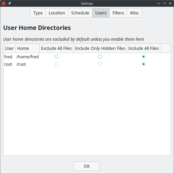

It seems you were right, it did not restore the home folder. There is no /home/fred folder. If I explicitly activate the home AND root folders to be backed up, it does not restore them both, or should I have checked the options for the home folder check before I restored it? It makes no sense to me but well…
So it seems I have to do it all over again.

The first time it seems I did not go far enough in the options to mark the home folder, but this time I did. Interestingly the result was the same. No home/fred. Path does not exist thus I cannot login.
The odd part about it is, that even if it did not copy my home folder, it should be there from the main install, which tells me that something got copied. Totally weird to me.
