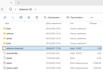

This is the original firmware, you can disassemble it and look at it

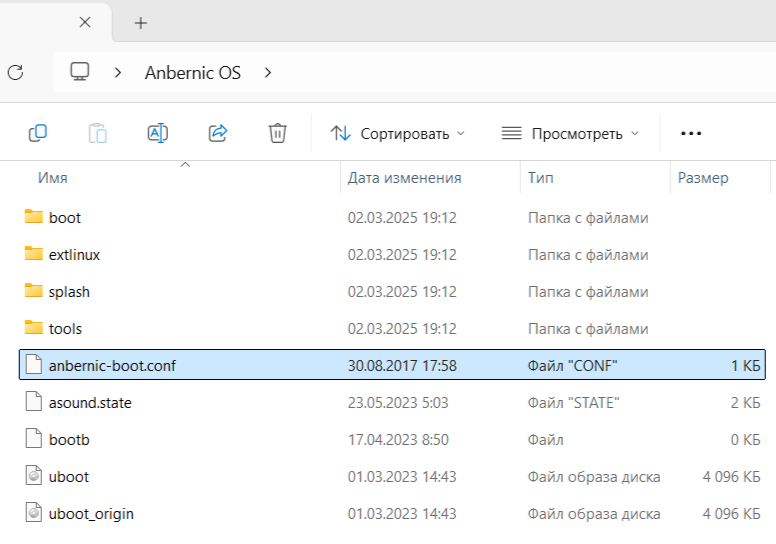

this is a photo of the folder manager with the original firmware, if that means anything to you.

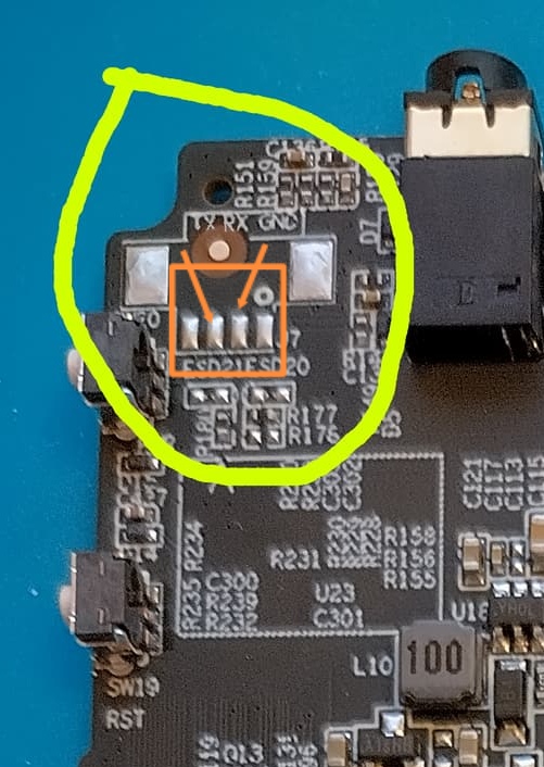

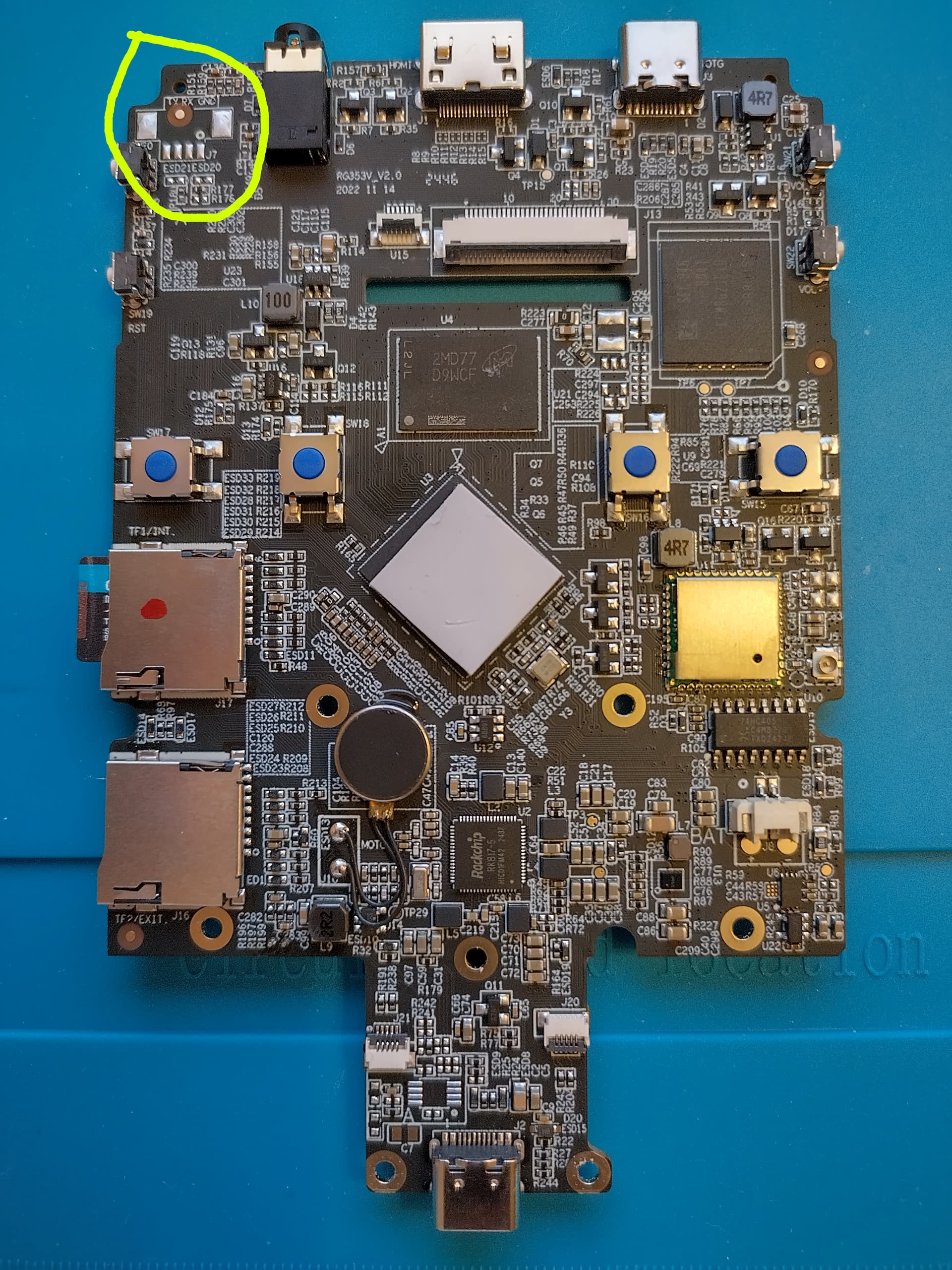

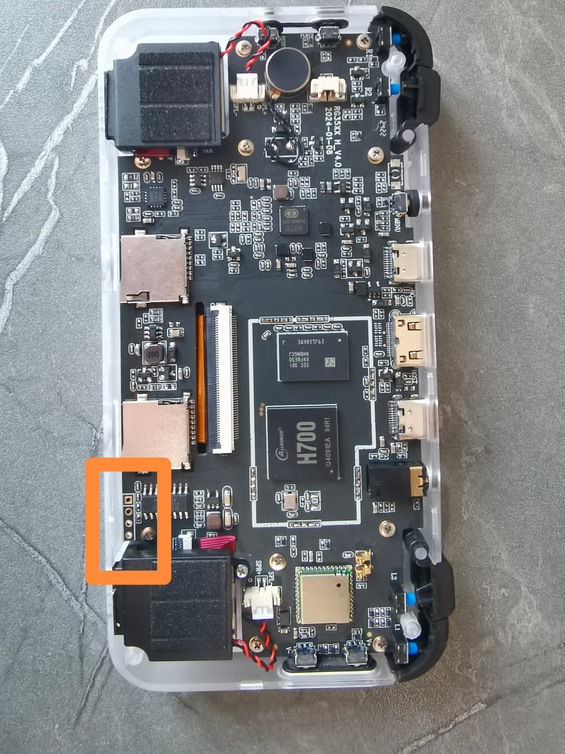

You’ve already disassembled the anbernic, right? Do you remember what the “hole” for the txd-rxd looks like?
Yes, here
Summary
I found a place where tx/rx should be but I don’t understand where the contact paths are for them
You can try 2 central pads. Don’t forget about GND connection
You need to measure the voltage on these pins, it should correspond to the voltage that your adapter is working with. Most often it will be 3.3V, common UART adapters work with this voltage too
great, now I just need to figure out how to attach it neatly to these pins

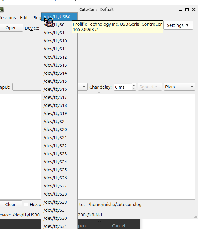

This port is from the converter, right?

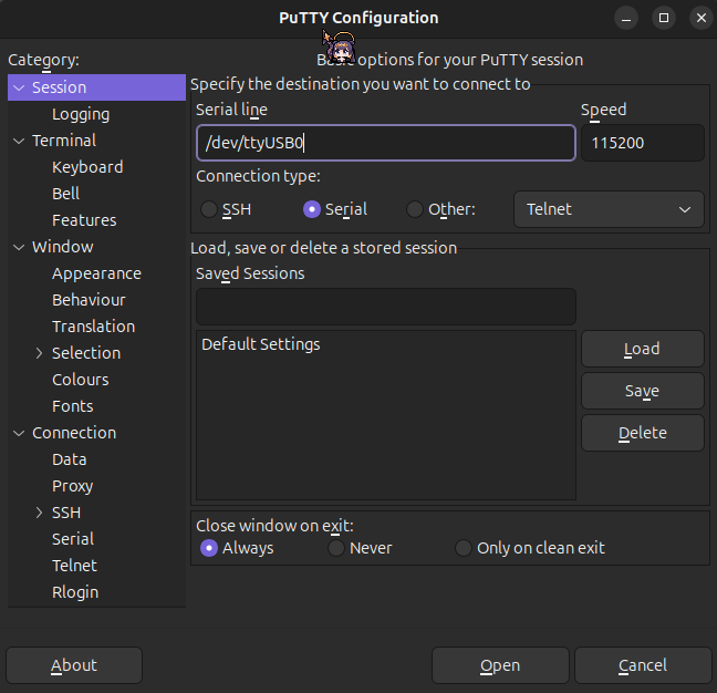

I use PuTTY for Linux,
but when I want to run it, for some reason it crashes
