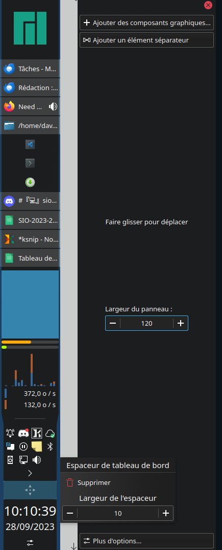

Need editing to have vertical task manager correctly displayed
Alignment tiny box with clock in the task manager need to edit then end (without any other action) to be well displayed. See the image GIF below…
KDE Plasma task manager display
Okay.

I’ve found a solution that seems to match my problem.
When right clicking on task manager and choosing editing, there is a option to add a separator item.
It needs many closing editing mode / entering editing mode, but after few manipulations (with one to uncheck flexible size), I could create a 10 pixels separator.
Today, after first start of my computer, menu is ok (no more overlap). I’ll close this post if it’s okay for few days.

Ok my theoretical solution is simpler.
In edit mode, right click on Afficher les altérnatives and select Icons-Only Task Manager instead of Task Manager.
It should shrink your panel to your wanted size?
