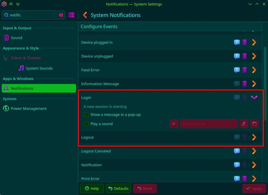

However, after looking at this thread on KDE Discuss, I wonder if you might have Plasma set to play a sound when you login. If it is enabled, disabling the login sound might prevent the audio from being unmuted when you login.
You can check via System Settings → Notifications → Configure for System (at the top right of the page). Scroll down and see if “Play a sound” is enabled for Login (and possibly Logout too):
If it is enabled, disable it, save the change & see if it works. If it doesn’t, it could also be related to another notification (such as “Device plugged in” if you have something attached to your device, such as an external drive).
If that doesn’t work, you could also see if disabling all notification sounds via System Settings → Colors & Themes → System Sounds works. However, you may find that option inconvenient as you won’t hear important alerts, even when your audio is not muted.
If neither of the above resolves the issue, then a more detailed look at your system may be required.

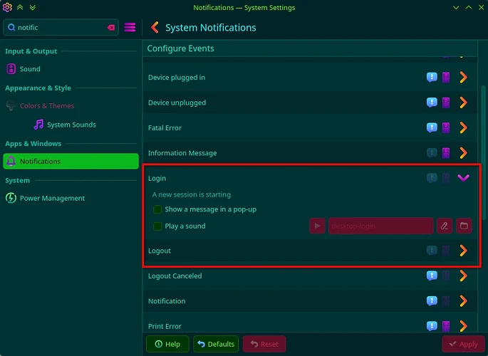

I’ve checked, both login and logout sounds are disabled
I have tried both themes that come up here with the “Enable notification sounds” option on and off, neither fix the issue

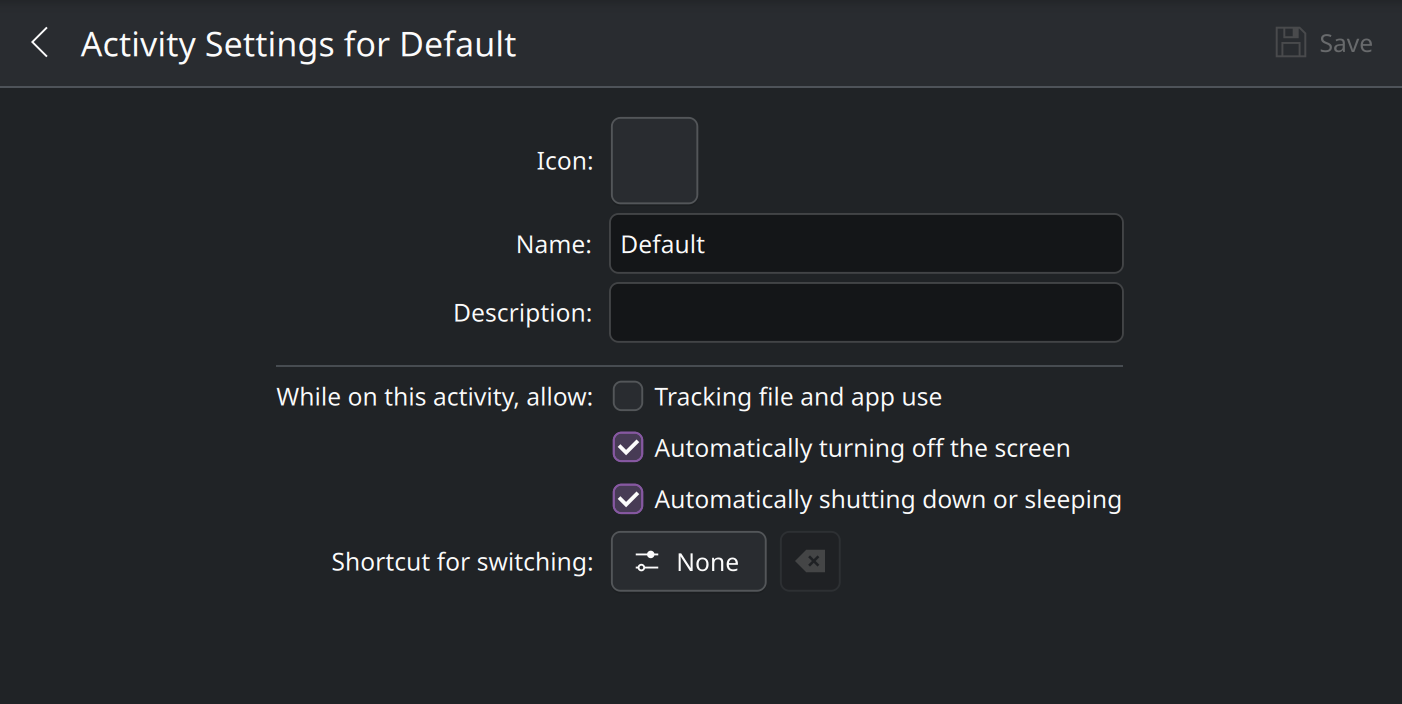

Have you checked the (advanced) settings for your Activities?
I assume you mean kde activites which are found under “Apps & Windows” in system settings. I do not use activities so there is only the default activity and also I can’t find advanced settings for it
If you click the default Activity in System Settings, you will see options there with respect to sleep and hibernation, as well as how multimedia must be handled.
This is everything shown when clicking on the default activity. From my understanding these options shouldn’t be relevant here.
