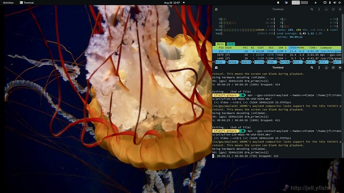

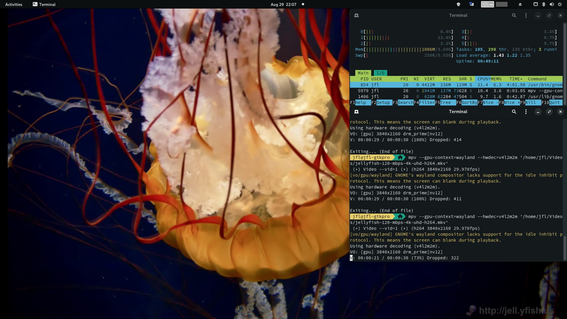

With 4k-uhd-h264.mkv dropped frames is around 40%.
 jfl@jfl-gtkpro    mpv --gpu-context=wayland --hwdec=v4l2m2m '/home/jfl/Videos/jellyfish-120-mbps-4k-uhd-h264.mkv'
 (+) Video --vid=1 (*) (h264 3840x2160 29.970fps)
[vo/gpu/wayland] GNOME's wayland compositor lacks support for the idle inhibit protocol. This means the screen can blank during playback.
Using hardware decoding (v4l2m2m).
VO: [gpu] 3840x2160 drm_prime[nv12]
V: 00:00:29 / 00:00:30 (100%) Dropped: 360
Exiting... (End of file)

On Rpi4 can the mpv stream jellyfish-120-mbps-4k-uhd-h264.mkv without high dropped frames?
On my device dropped frames 360 is equivalent to 40% dropped frames [360/(30x30)] and video was jerky.
