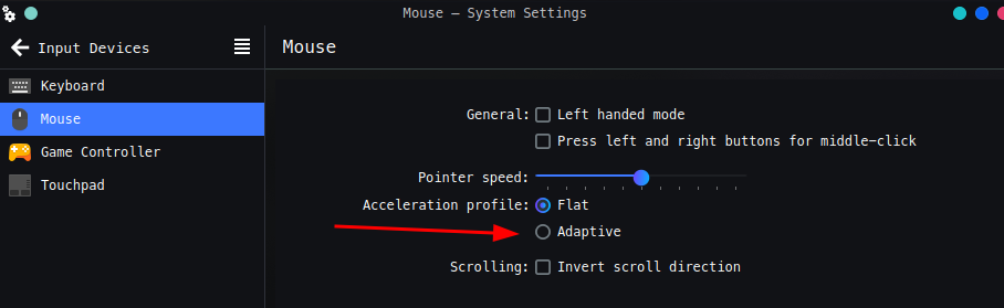

are u using adaptive ?
Then the mouse is broken.
Yes

adaptive adds acceleration to ur mouse so if u move more it feels more speed move less then less speed
it also happens if u use gamescope with wine apps , that changes mouse sensi on system

Thank you, il set this to the other potion as i do suspect it is this.

Just to confirm, it is that. It started with
[Stable Update] 2023-04-11
xf86-input-libinput 1.3.0 DPI and mouse acceleration issue on KDE Plasma X11
That issue was fixed in the 2023-06-04 update, 3 months ago, but because of complicated reasons the fix may have left that option in the wrong state depending on what it was set to previously. Just changing it as you’ve done is all that is required.
