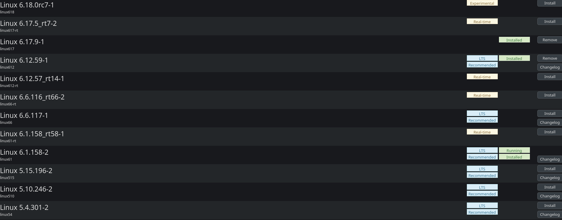

"Manjaro Settings Manager > Kernel > Remove" will often times not delete old kernels
Hello again,
Just for context, the kernels that I am trying to delete are still supported, but are not running while I try to delete them. The kernels stay installed even after a reboot. The operation is however reported as successful by the GUI even though it is not.
Also, I have tried having a look at the CLI for the application “manjaro-settings-manager” but it does not seem to be very functional.
Environment
App version: manjaro-settings-manager 0.5.8-7
Branch: testing
Kind regards

I thought it was there by default but my install is old, maybe it was removed at some point :man_shrugging:
I just installed update-grub ran it and rebooted the system, which is now booting up with the newest installed kernel.
The GUI tool works now. Does its correct functioning depend on “update-grub” being installed?
Yes, it does.
And there we go! Thank you, everybody.
