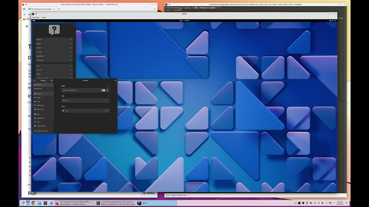

Download the live ISO and simply install it using the graphical installer. Watch this short video to see how you can try it out with vanilla QEMU:
Alternatively you can use VirtualBox, a QEMU front-end such as gnome-boxes, or install directly to physical hardware. Just make sure to enable UEFI support in the virtual machine configuration or that you are testing on UEFI enabled hardware.
Schermafdruk van 2024-07-31 19-30-22
Rigorous discussion by the team on which VM solution to recommend
