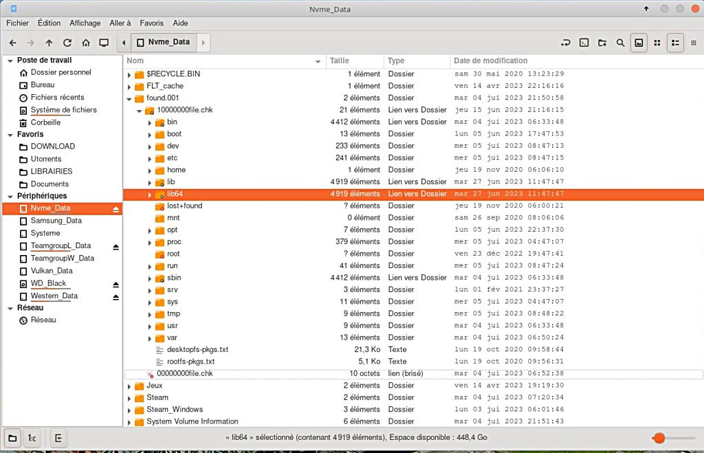

For those interested, here’s a snapshot of those strange error files (found.00x) in Manjaro, not the boot drive. It looks like a copy of the file system ??? I have the same file(s) on another mounted volume too.
