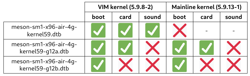

Update 2: (Still no) sound on X96 Max+ - but problem narrowed down
I did another series of extensive tests to get sound running on my X96 Max+ with mainline kernel. All tests were done using only one sd card running Manjaro Arm XFCE where I changed .dtb’s and kernels.
You can find the three dtb/dts files that I used for testing here.
Starting point is the .dts from chewitt from his 5.9.y kernel branch (see here) which I compiled and named meson-sm1-x96-air-4g-kernel59.dtb. With this I can boot my box and sound and ethernet is working well with linux-vim kernel. However, as pointed out before the mainline kernel does not boot with this .dtb.
(Thanks @dante6913 for confirming that it also does not work on X96 Air! (x96maxplus.dtb is quite similar to above .dtb))
I won’t go into detail about all my failed attempts here. So, to make a long, long, long journey short: I finally found out that only one single line in ‘meson-sm1-x96-air-4g-kernel59.dts’ is responsible for the .dtb not to boot with mainline kernel.

I have called the new .dts files ‘meson-sm1-x96-air-4g-kernel59-g12a.dts’ and ‘meson-sm1-x96-air-4g-kernel59-g12b.dts’, respectively.
With these three .dtb’s I checked if mainline kernel is booting, if soundcard is recognized (aplay -l) and if sound is working. I have summarized the results in the following table:
Although - as you can see - I still get no sound in the mainline kernel it seems to be purely connected to the fact that “sm1” driver is not used for the clock because sound is also broken in the VIM kernel when using “g12a” or “g12b” drivers for the clock.
So, @spikerguy and @Strit, I hope that these results may have narrowed down the problem a little bit and help you to find a fix for the problem (hopefully soon :smiley:)!
(BTW, I guess you are aware of the S905X3 documentation that you can find here?!? Details about sound registers start at p. 781)

Thanks @spikerguy! Soundcard is still recognized when changing compatible = "amlogic,sm1-audio-clkc"; to compatible = "amlogic,g12a-audio-clkc"; which I need to do to get my box booting when using mainline kernel (see table in my last post).
I have installed the new package and ran the script but it did not fix the problem. :frowning_face:
I have the strong feeling that sm1 clock driver (and not g12a or g12b) has to be used to get sound working on S905X3.
There must be a reason that sound is working with sm1 driver with VIM kernel (and not working when using g12a or g12b also with VIM kernel). And there must be a reason that mainline kernel is not booting when sm1 driver is set in .dtb.
Therefore, may I ask if you or @Strit can have another look at the implementation of “sm1” clock driver in vim kernel compared to mainline kernel?
The solution to the problem must be within the vim kernel because sound is working when using the vim kernel and not working with mainline kernel. So, there must be a difference somehow.
I think to remember that you wrote that you have a Vim3L which is based on S905D3 that is almost identical to S905X3 (except for DSI output and CSI input). Shouldn’t it be possible to do testing with this device? Or does sound already work on Vim3L using mainline kernel?

As suggested I did a comparison of chewitt’s meson-sm1-x96-air-4g.dtb that I use and meson-sm1-odroid-c4.dtb and code for sound section, audio clock and audio-controllers are identical. And - as expected - odroid.dtb also uses compatible = "amlogic,sm1-audio-clkc";
So, in principle meson-sm1-x96-air-4g.dtb should work with the mainline kernel but (as described before) it does not boot when sm1 driver is used in audio clock controller section :frowning_face:
I am really running out of ideas why x96air.dtb boots and sound is working with the VIM kernel and it does not boot with mainline kernel.
I think your and @spikerguy’s expertise is desperately needed here again …
