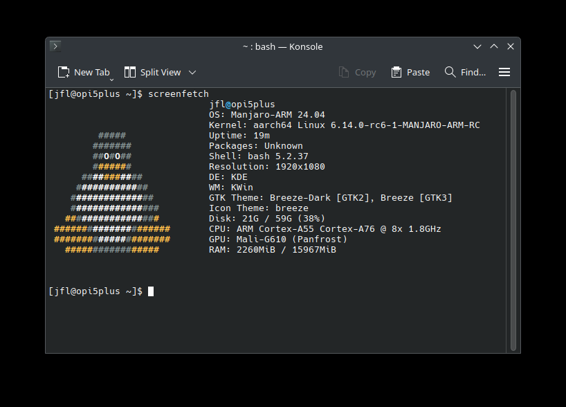

Thanks. linux-rc-6.14-rc6-1 boot up successfully on Opi5-Plus.
