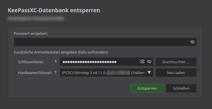

I have a very strange behavior with my Nitrokey and KeePassXC where I need help.
Since KeePassXC 2.7.6 the Nitrokey is supported.
KeePassXC only detects the Nitrokey if is is plugged in before KeePassXC starts.
I can also unplug the stick and plug it back in, KeePass finds it again (sometimes only after the second search).
The pcsc_scan command always finds the Nitrokey, even if it was inserted after logging in.

I would like to test pcsc instead of ccid driver. As I see it, ccid is used.
As described in the Arch wiki, I have created the file ~/.gnupg/scdaemon.conf. With and without the configuration file I have the same behavior.
What do I do wrong?
