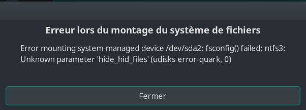

The system boots without any issue, but there is something special : I have suddenly troubles to mount a NTFS disk that usually is mounted on boot.
Here are the issues : As I could not launch a game that was installed on this drive, I opened Dolphin to check in /mnt if I could access it. The folder was empty.
I use “Gnome disk” to check if the disk is mounted or not, but when I try to mount it, I have the following message :
It’s surprising because “hide_hidden_files” was working in my fstab since my first Manjaro install one year ago more or less. When deleting this parameter in the fstab line, I can access the disk in Dolphin but in read-only mode, So I’m not able to use the softwares on it as usual, nor my Windows 10 VHD in Virtualbox.
I’m sure that the issue went during or just after the update because I was able to use this disk everyday the days before.

hide_hidden_files is not what the error message says. Maybe you have a typo in Fstab. …hidden
Thank you for the suggestion, you are correct, I wrote “hidden” but the setting seems to be “hide_hid_files” because I can find it on two trustworthy sources (Fstab/fr - Manjaro) and (ntfs-3g(8) — ntfs-3g — Debian bookworm — Debian Manpages). But It don’t seems to work, I always have the same message… :thinking:
Apart of that, I can easily delete this optional setting and this is what I have on fstab for this specific NTFS disk :
/dev/disk/by-uuid/80A6D052A6D049F4 /mnt/80A6D052A6D049F4 auto defaults,windows_names,relatime,nosuid,nodev,nofail,x-gvfs-show 0 0

If I remember correctly hide_hid_files is specific to ntfs-3g NOT ntfs3. You’ll need to specifically make sure you’re using ntfs-3g.
You can check, by running mount and if the mount line for that device lists ntfs3 then you’re not using ntfs-3g driver.
i.e. Change your fstab entry from auto to ntfs-3g
I think this is the most likely suspect, at least listed in this thread anyway.

OK I’m very sorry, it seems that I had a typo, forgetting the “-” between “ntfs” and “3g” … :face_with_spiral_eyes:
Now I have this line in fstb as suggested initially :
/dev/disk/by-uuid/80A6D052A6D049F4 /mnt/80A6D052A6D049F4 ntfs-3g defaults,noatime,nosuid,nodev,nofail,x-gvfs-show 0 0
And this line with the command “mount”, at the end of the devices list :
/dev/sda2 on /mnt/80A6D052A6D049F4 type fuseblk (rw,nosuid,nodev,noatime,user_id=0,group_id=0,allow_other,blksize=4096,x-gvfs-show)
And I have the full access on my NTFS drive, writing is possible, even if the result of ls -la seems to be the same as before :
