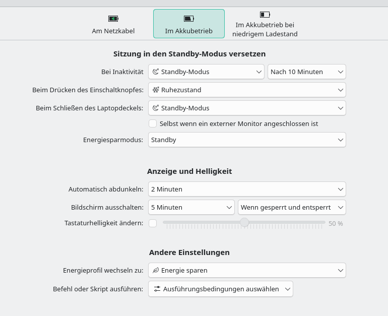

The interaction between standby and hibernate is not functioning as expected. Normally, I can close the laptop lid and it goes into standby mode. It only loses a small amount of battery power overnight. I don’t just close the lid, I actively put it into standby mode first.
I did that yesterday as well. This morning, I opened the laptop and saw that the battery was only at 2%. This leads me to two questions:
  1. Why does it wake up on its own when the lid is closed?
  2. The power settings are actually set to put it into hibernate mode when the battery is at 5%—why isn’t it doing that?

As you can see, I actively selected standby mode at 8:53 p.m. The laptop performed all activities after this time independently with the lid closed. Do you require any further information?

I think I’ve found something. Sorry, the screenshot is only in German, but for the power settings when running on battery and with a low charge, the power saving mode is set to “Standby.” Should I perhaps change that to “Standby and then Hibernate”?
It happened again. Yesterday at 9 p.m., I manually activated standby mode and closed the laptop. I can see in the log that it woke up at 1 a.m., 2 a.m., and 5 a.m. (presumably for the check). When I opened it again at 8 a.m. this morning, the battery was at 2%. This is doubly annoying.
Firstly, that it doesn’t at least go into hibernation mode. I increased the critical battery level limit to 10% and the standby mode is now set to “Standby and then hibernation.”
Secondly, why is the battery consumption so high in the first place? I turned it off yesterday with about 60% battery life, and after 11 hours of standby, it’s almost completely empty!
But something just occurred to me. I updated to Manjaro 26.0 a few days ago, and since then, there’s only Wayland. Before that, I had only used X11. Could that have something to do with it? How can I further debug both problems?
