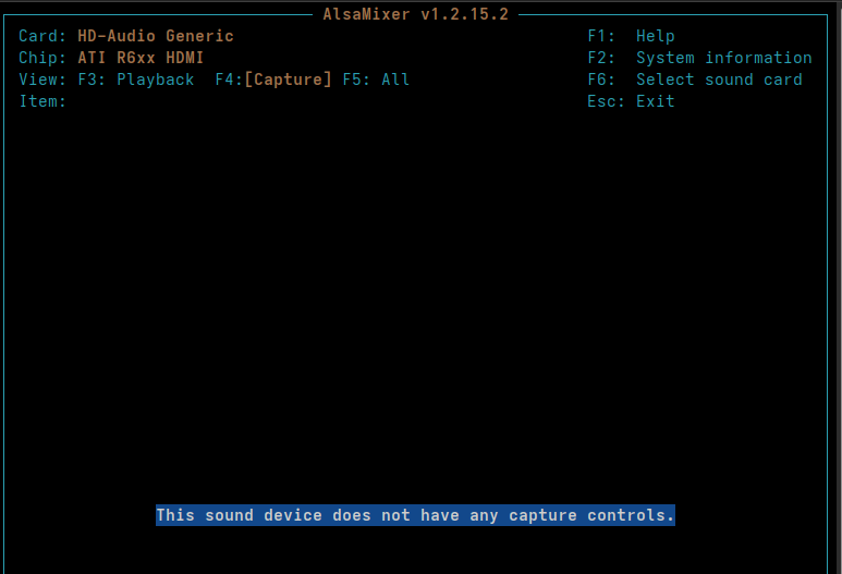

I suggest check ALSA mixer setting for onboard audio device:
amixer -c1
Audio capture is usually disabled by default:
Simple mixer control 'Capture',0
  Capabilities: cvolume cswitch
  Limits: Capture 0 - 63
  Front Left: Capture 0 [0%] [-16.00dB] [off]
  Front Right: Capture 0 [0%] [-16.00dB] [off]
To enable audio capture and set microphone recording level
amixer -c1 sset 'Capture' 39 cap
https://linux-hardware.org/?probe=7dfc0bb8cb&log=amixer
  Front Left: Capture 39 [62%] [12.00dB] [on]
  Front Right: Capture 39 [62%] [12.00dB] [on]
Or use alsamixer to change audio capture settings:
alsamixer -c1 --view=Capture
Thanks for replying…
amixer -c1
Simple mixer control 'PCM',0
  Capabilities: pvolume
  Limits: Playback 0 - 255
  Mono:
  Front Left: Playback 255 [100%] [0.00dB]
  Front Right: Playback 255 [100%] [0.00dB]
Simple mixer control 'IEC958',0
  Capabilities: pswitch pswitch-joined
  Playback channels: Mono
  Mono: Playback [on]
Simple mixer control 'IEC958',1
  Mono: Playback [on]
Simple mixer control 'IEC958',2
  Mono: Playback [on]
Simple mixer control 'IEC958',3
  Mono: Playback [on]
I don’t have “capture”…
Card 1 is for HDMI digital outputs only, internal digital mics and analog inputs/outputs are probably on Card 2 ( -c2 )
Please get more information about all ALSA devices:
sudo alsa-info.sh --upload
As a new user, forum software may not allow you to post an active link to the uploaded data, but an inactive link can be posted as preformatted text </> [Ctrl+E]
http://alsa-project.org/db/?f=...
Thank you for patience…
(http://alsa-project.org/db/?f=07c4ecd58f9674d11e6627d9ee2feac1b2997079)
ALSA data shows analog microphone inputs for external microphones, but no internal digital microphones
