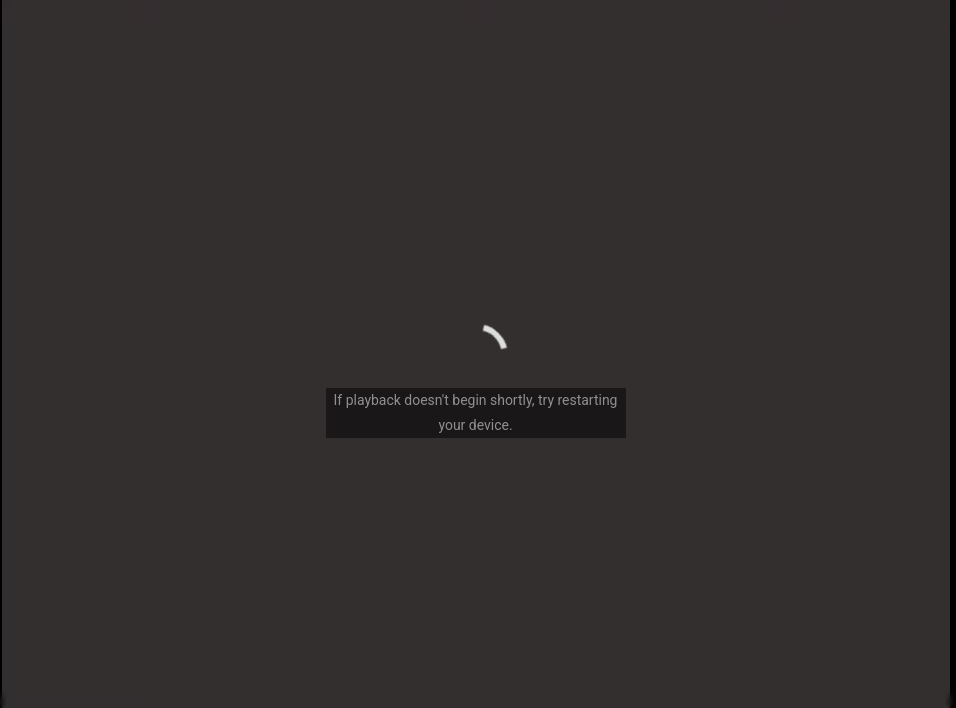

this happens on youtube when the audio is broken
well, after watching a video from Unfa on YouTube I decided to ditch pulseaudio and welcome PipeWire , so I uninstalled everything that was related to pulseaudio, (except for a library 32 that was a dependency for other thing). And that was it, after a reboot: videos, games , etc. everything worked again, no bash function involved. It went smooth like silk, the only problem tho, was that I don’t have a volume control anymore in the bar at the bottom right of the screen, I can change volume with alsamixer on the terminal, which I made an alias so I can change it faster.
