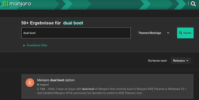

There are many solutions in the Forum, the Search Function will help…
