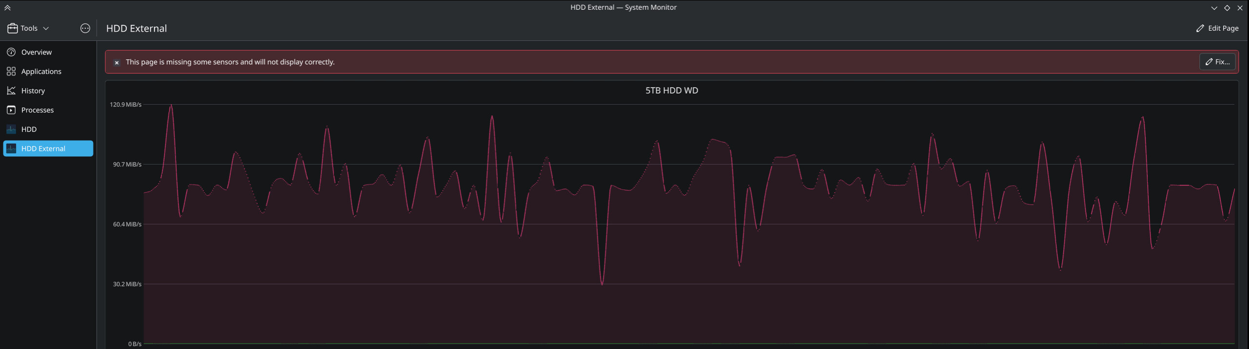

Now speeds went from a max of 24MB/s to 120MB/s

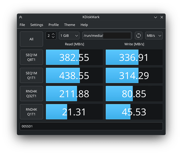

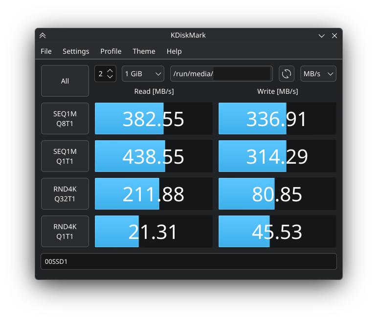

I just tested right now a Crucial BX100 SSD in an external ORICO enclosure [ASMT105x] with KDiskMark (details below)
Bus 002 Device 004: ID 174c:55aa ASMedia Technology Inc. ASM1051E SATA 6Gb/s bridge, ASM1053E SATA 6Gb/s bridge, ASM1153 SATA 3Gb/s bridge, ASM1153E SATA 6Gb/s bridge
Try removing udev-usb-sync if you have it installed, otherwise there may be some other reason at play here… don’t settle for 30MB/s over USB! There is a glitch in the Matrix somewhere! :alien_monster:
