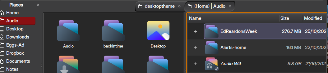

  1. Open Dolphin, activate Settings with CtrlShift, - On the first pane (Interface) you will see Split View options. First, activate ‘Switch with Tab key’ and second, note ‘Turning off split view closes the view in focus’. You must experiment with this, because you’re going to have to learn to deal with it and develop some automatic reactions… but my vote is for F3 to always act on the ACTIVE tab.
TEST 1. Open home (single pane). Arrow to select a folder, then hit F3 to activate the other pane…
I have ~/Audio one side, then it’s contents on the other (but could be any folder). I am now (logically) focussed on the RIGHT pane, the contents pane… makes sense. Hitting F3 will kill that pane (due to MY setting) and TAB will focus the LEFT pane.
If you now do the AltF4 and MetaE shuffle (close/open Dolphin) you’ll be focussed where you left off. This would be the proper behaviour.
However, if you now hit TAB to focus the left panel, press arrow keys to select another folder, enter that - then do the AltF4 and MetaE shuffle - your focus is now lost, and you are returned to the RIGHT panel.
Your solution to always focus the LEFT panel is (IMO) equally wrong; but could be made optional I guess. The thing is - whilst hitting F3 with a folder selected will open it in a new pane, hitting F3 again will close the original pane…
I’m finding it easier to deal with F3 acting always on the focussed pane… and TAB serving to close the ‘other tab’ (i.e. TabF3).
Overall there have been a couple of ‘regressions’ with Plasma going to 6.5, and KDE Developers are actively reading these arguments and puzzling on how best to deal with them…
The most interesting one for me is that if you now open a folder, then click ‘Create Folder’ four times, you don’t get 4 folders in the PWD - because Dolphin is on a ‘follow focus’ mission… so you can click it 4 times and you’ll get Folder1/folder2 Folder3/folder4 (i.e. one folder, one nested, then another folder and another nested)…
So yes, Dolphin’s messed up - take control with TAB and F3.

The solution (for me) was to change the setting for F3… so now (open one pane) F3 will open a new pane and shift focus to it, but if I hit F3 again, it will close the ACTIVE pane (not the ‘other’ pane as I set it before).
So TAB and F3 can keep control of focus and actions with panes… meanwhile KDE Devs have to think about the consequences and unforseen issues they brought to Plasma 6.5 and hopefully iron them out.
This would be an ideal option if you prefer this, otherwise a setting to choose ‘Always focus LEFT’ or ‘RIGHT’ pane should be configurable…
But either way, it’s predictable (always the RIGHT pane now) and can be made more obvious with a well tweaked theme:
Here, Kvantum (3d) has a nice outline…
Here ‘Marbles’ makes it white…
Both are set to the same location.
As I explained: source and destination get switched when I start using it when the right is active on startup rather than the left. This might be my idiosyncrasy but I am used to it.
It is not the startup locations but which side—right or left—is active on startup. Tab will fix it anyway.
