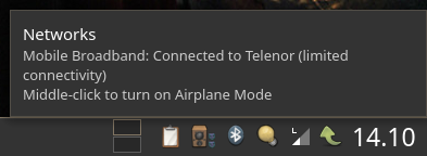

Verify that all packages has been installed before proceeding - check the /var/log/pacman.log - when all is done symlink the fcc-unlock script
Activate fcc-unlock script
sudo ln -s /usr/share/ModemManager/fcc-unlock.available.d/8086:7360 /etc/ModemManager/fcc-unlock.d/8086:7360
Enable and start the ModemManager service
sudo systemctl enable --now ModemManager
Result

nmcli -m 0
 $ mmcli -m 0
  General  |                   path: /org/freedesktop/ModemManager1/Modem/0
           |              device id: b776b707c73cf296b6228e1f1aa09ba6436100e4
  Hardware |           manufacturer: Fibocom
           |                  model: L850 LTE Module","L850
           |      firmware revision: 18500.5001.00.04.26.22
           |              supported: gsm-umts, lte
           |                current: gsm-umts, lte
           |           equipment id: 015550001546651
  System   |                 device: /sys/devices/pci0000:00/0000:00:01.5/0000:04:00.0
           |                physdev: /sys/devices/pci0000:00/0000:00:01.5/0000:04:00.0
           |                drivers: iosm
           |                 plugin: Intel
           |           primary port: wwan0at1
           |                  ports: wwan0 (net), wwan0at1 (at), wwan0xmmrpc0 (xmmrpc)
  Status   |         unlock retries: sim-pin (3), sim-puk (10), sim-pin2 (3)
           |                  state: connected
           |            power state: on
           |            access tech: lte
           |         signal quality: 9% (recent)
  Modes    |              supported: allowed: 3g; preferred: none
           |                         allowed: 4g; preferred: none
           |                         allowed: 3g, 4g; preferred: none
           |                         allowed: 3g, 4g; preferred: 3g
           |                         allowed: 3g, 4g; preferred: 4g
           |                current: allowed: 3g, 4g; preferred: 4g
  Bands    |              supported: utran-1, utran-4, utran-5, utran-8, utran-2, eutran-1,
           |                         eutran-2, eutran-3, eutran-4, eutran-5, eutran-7, eutran-8,
           |                         eutran-12, eutran-13, eutran-17, eutran-18, eutran-19, eutran-20,
           |                         eutran-26, eutran-28, eutran-29, eutran-30, eutran-41, eutran-66
           |                current: utran-1, utran-4, utran-5, utran-8, utran-2, eutran-1,
  IP       |              supported: ipv4, ipv6, ipv4v6
  3GPP     |                   imei: 015550001546651
           |            operator id: 23802
           |          operator name: Telenor DK
           |           registration: home
           |   packet service state: attached
  3GPP EPS |   ue mode of operation: csps-2
           | initial bearer ip type: ipv4v6
  SIM      |       primary sim path: /org/freedesktop/ModemManager1/SIM/0
  Bearer   |                  paths: /org/freedesktop/ModemManager1/Bearer/0

The NetworkManager integration may display a limited connectivity message - this is not a lack of connection :man_shrugging:
