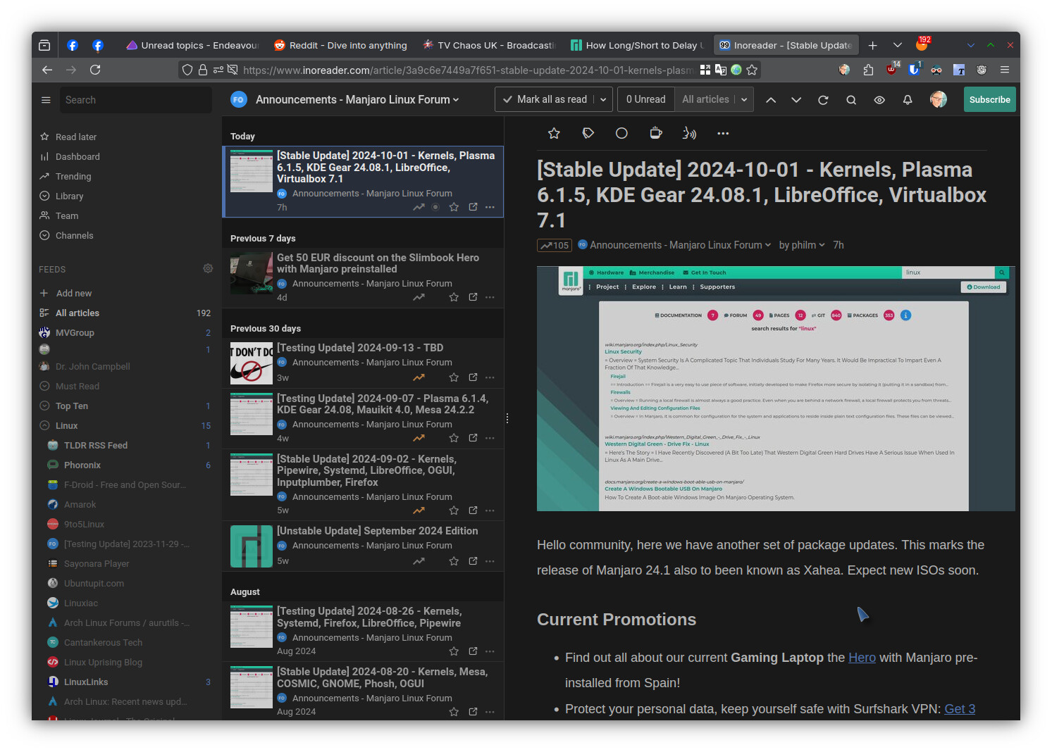

If you shove something like Inoreader extension in Firefox, and add the RSS feed for Stable announcements, then you’ll get to see and read what’s coming - if you have snapshots/backups then there’s less fear as you can roll back.
