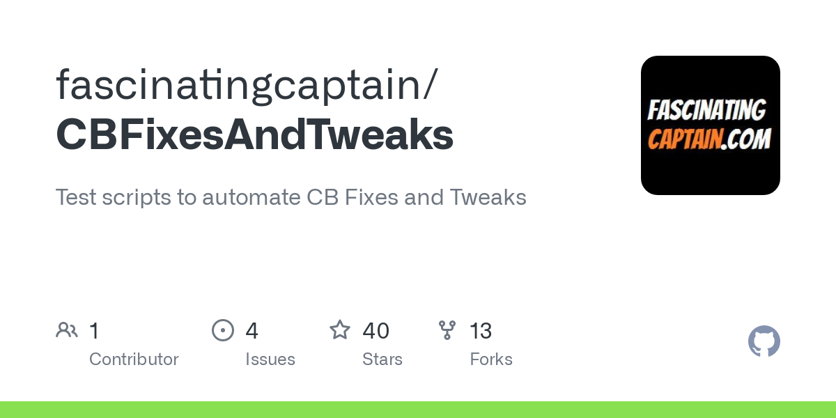

I used the following github code to enable my Chromebook’s picture keys. However, this had a drawback in that the Function keys were disabled - if that should matter.
