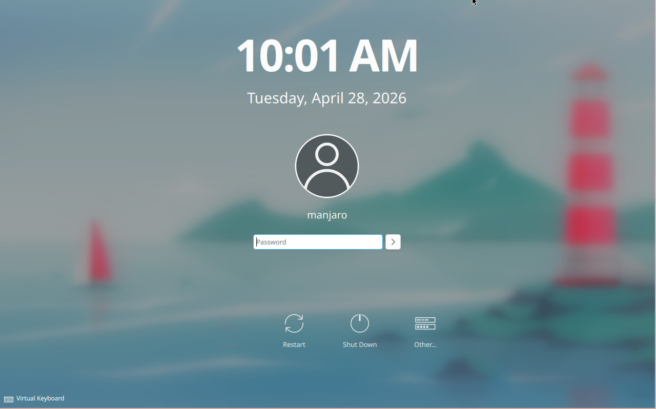

How do I install the KDE Plasma display manager theme on XFCE4?
Hello everyone.
Could you please tell me how to install the KDE Plasma display manager theme on XFCE4?
With all due respect to lightdm, the display manager theme looks awful to me from a design perspective, especially when the display resolution is high and the login and password window is so small – it’s completely out of proportion))
I understand that I need to install SDDM and run it, but what do I need to do next?
If, after installing SDDM, I don’t see the configuration file
/etc/sddm.conf
do I need to create it? Will that work?
If, for example, I downloaded the sddm-breath-theme from the repository Branch compare for Manjaro and set it in the configuration file:
$ sudo nano /etc/sddm.conf
[Theme]
Current=sddm-breath-theme
Will that work?
I want to have this theme at XFCE when I log in. :backhand_index_pointing_down:

This doesn’t look right. First SDDM isn’t “the KDE Plasma diplay manager”. This would be the new Plasma Login. SDDM can be used with any desktop environment. It’s a QML application but this doesn’t make it Plasma (which also uses QML). Notice that SDDM runs as systemd service. How to configure and use is described in detail in the Arch Wiki.
It is fairly simple to use sddm instead of lightdm on Xfce desktop.
sddm is a desktop agnostic display manager whereas plasma-login-manager has been tailored specifically for the Plasma desktop - much like gdm has been for Gnome desktop.
Install the package sddm and the sddm-breath-theme theme.
sudo pacman -Syu sddm sddm-breath-theme
The use of /etc/sddm.conf is deprecated and you should create a drop-in configuration as /etc/sddm.conf.d/my-theme.conf
[Autologin]
Relogin=false
Session=
User=
[General]
HaltCommand=/usr/bin/systemctl poweroff
RebootCommand=/usr/bin/systemctl reboot
[Theme]
Current=breath
[Users]
MaximumUid=60513
MinimumUid=1000
Then set sddm as the greeter
sudo systemctl enable sddm --force
Then restart user-space
systemctl soft-reboot

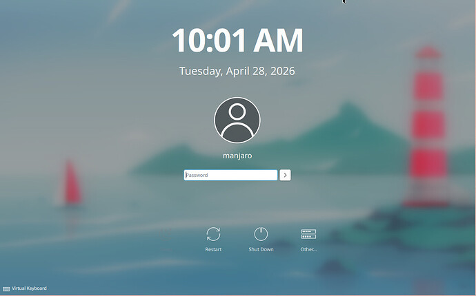

@linux-aarhus method of installing SDDM is the best option, as installing the lightdm-kde-greeter theme turns XFCE4 into KDE Plasma with all the packages))
Now I need to find some interesting and stylish themes; these ones seemed more or less nice to me..

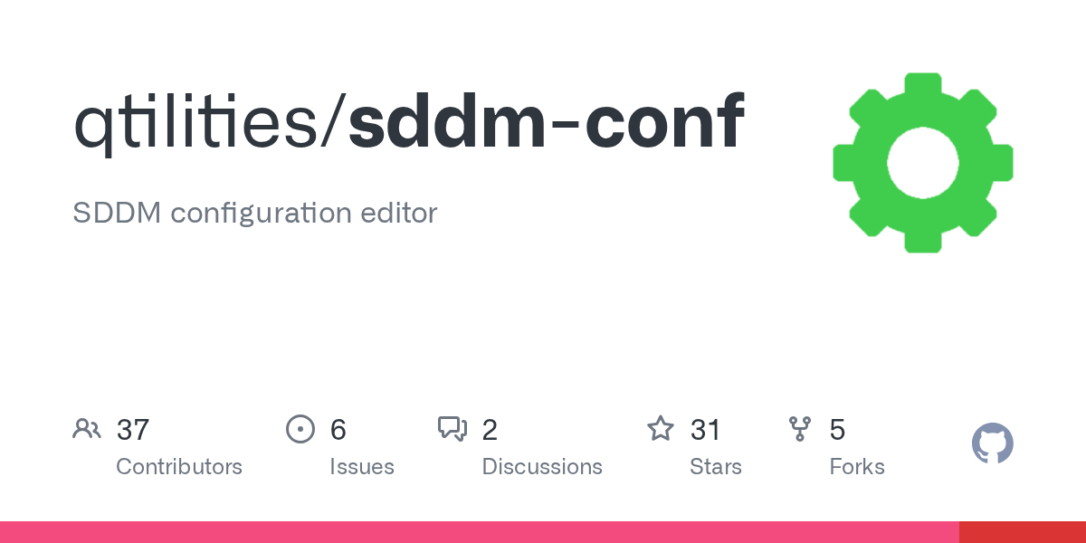

I forgot to mention that there’s a great programme that isn’t in the repository; it’s called sddm-conf – it’s a GUI for SDDM.
It’s a really handy, brilliant programme.
