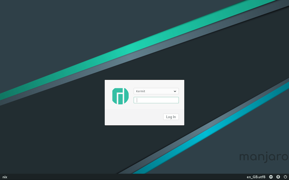

This is the default LightDM, greeter and theme for Manjaro XFCE (which I have obviously never edited):
Manjaro XFCE - LightDM
Customising this to your liking can be as simple as substituting the background for one that appeals to you; and/or (optionally) changing the Greeter.
:warning: Important: Avoid using 4K wallpapers – in fact, a background smaller that your monitor resolution can often be beneficial.
If a Greeter must specifically have the login controls on the left-hand side, as I believe you mentioned, then the Slick Greeter comes to mind as one option among likely many more;
