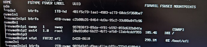

With my deepest apologies for posting a picture of text , I hope this screenshot helps clarify :
The partition, nvme0n1p3, does show up on lsblk -al, but thw filesystem is missing, as the above image shows. So… I don’t think it’s unformatted space?
Unfortunately this is exactly what it is (according to the system). There is just no partition there according to the partition table. But i have not restored a partition very long time and i have forgotten how it is done, so let’s wait the others. And i am entirely unsure how it works on ssds.
