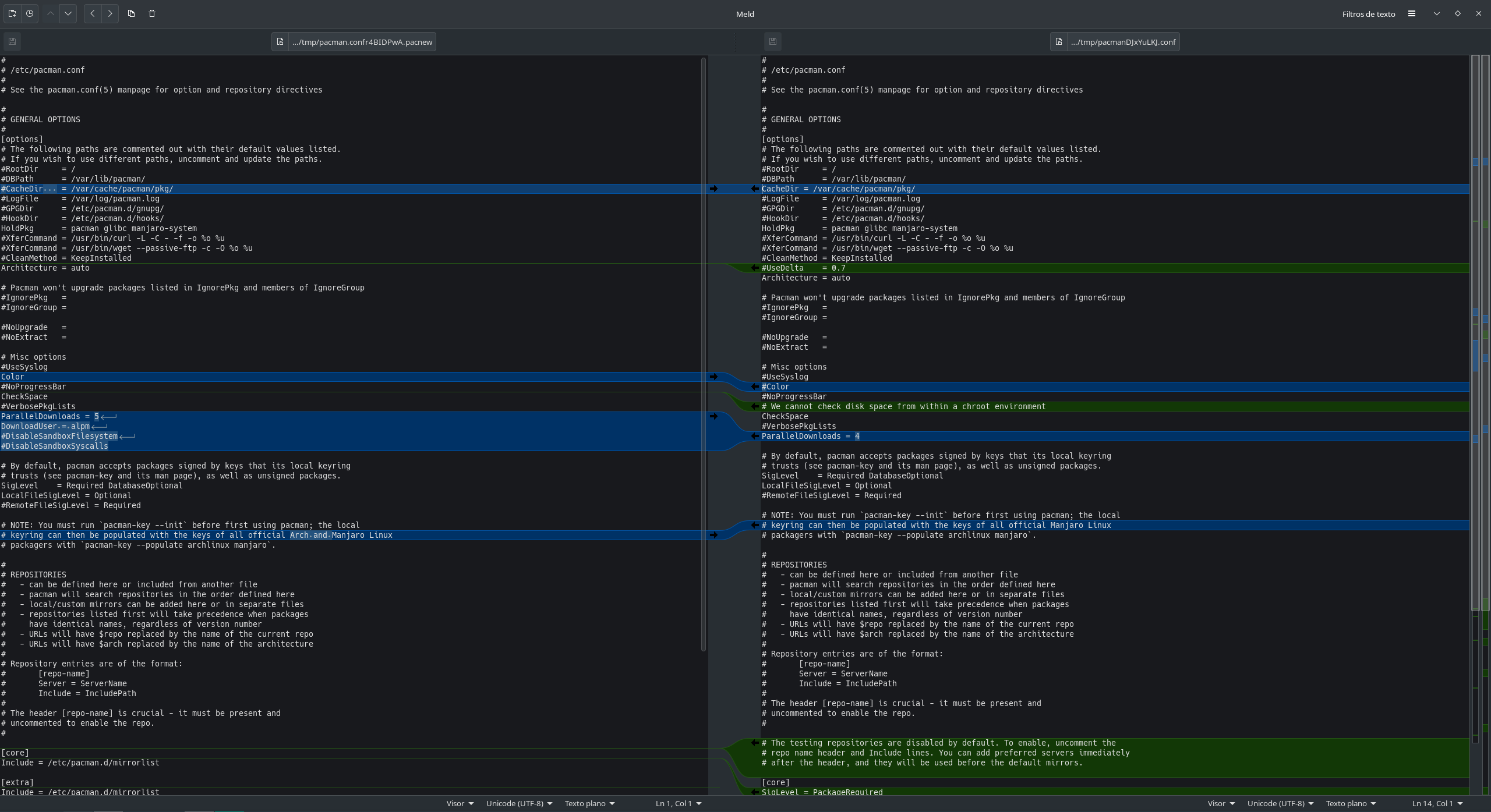

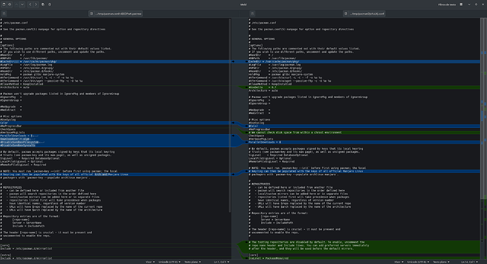

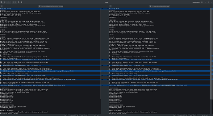

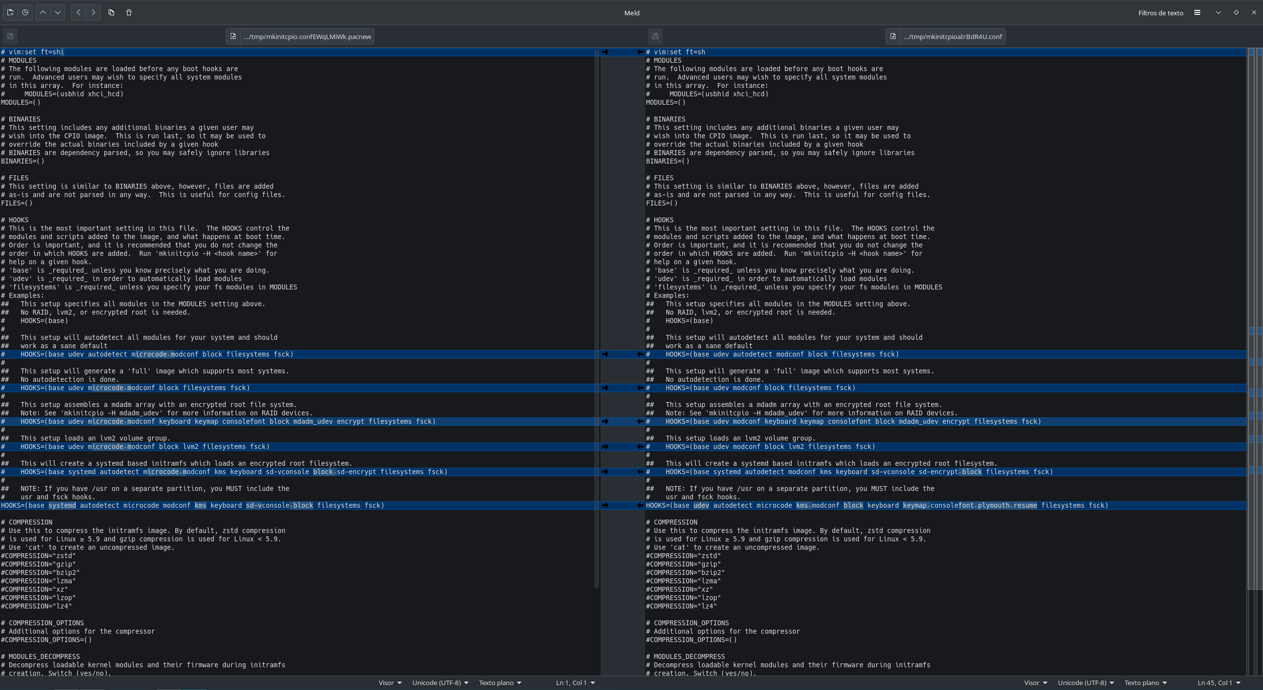

But now I have thise pacnew files that I don’t know what to do with:
/etc/mkinitcpio.conf.pacnew
/etc/pacman.conf.pacnew
/etc/makepkg.conf.d/fortran.conf.pacnew
I share meld screenshots, cause I don’t think code option is better in this case.

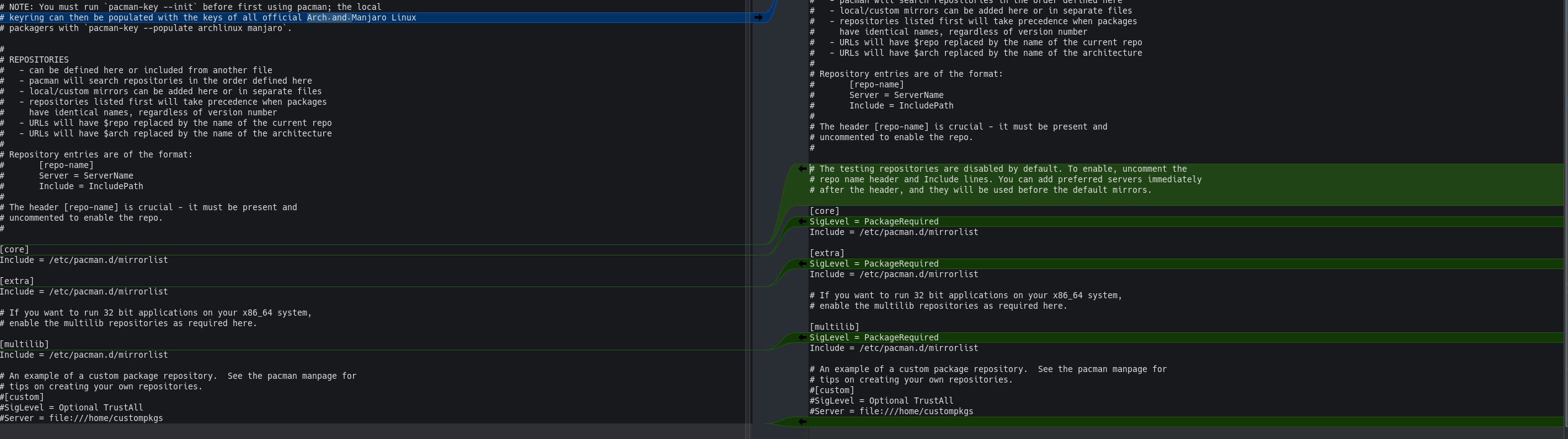

– The missing part from previous image, the blue line in the second one is the last one in the first image.
I know it is mention to just override with pacnew, but I want to confirm since I know nothing from here.
Thank you so much in advance.
mkinitcpio.conf
  • You do need the microcode hook.
  • If you use encryption, then it’s simpler to stick with the “HOOKS=(base udev ...)” syntax than to switch to the newer “HOOKS=(systemd ...)” syntax, because the latter also requires a change in the syntax for opening and mounting the encrypted filesystem. If you are not using encryption, then the new syntax is preferable.
Don’t forget to rebuild your initramfs after modifying the file. :backhand_index_pointing_down:
sudo mkinitcpio -P
pacman.conf
In general, it should be safe to overwrite the existing file with the .pacnew.
fortran.conf
Just replace the existing file with the .pacnew.
Hello and thanks for replying so soon. What about the semicolon in the first line of mkinitcpio.conf?
That’s just a vi/vim directive for when you open the file in vi/vim — I’m not sure what it means as I don’t use those editors. It either way bears no importance to the file itself. :wink:
Thanks and done, pacnews are no longer scary.
Why “do not need”? How do a user could understand it for their case?
GPT 5.4 nano tells:
" In /etc/mkinitcpio.conf, the microcode hook loads your CPU’s early microcode updates into RAM during the initramfs boot stage, so the kernel can switch to the updated microcode before the OS fully takes over.
If you have a package installed (e.g., Intel/AMD microcode) and you want those fixes (stability/security/CPU errata) applied as early as possible, you include the microcode hook.
Practical check for your case:
  • If you have Intel: /boot/intel-ucode.img should exist.
  • If you have AMD: /boot/amd-ucode.img should exist. If those files exist, keeping microcode is the normal/correct approach, and you just rebuild initramfs after changing HOOKS.
Why do you think that an early vulnerability, stability patching give nothing?
Also, “do not need” == “suggestion to remove”?
Maybe I’m misunderstanding something here, but @Aragorn says, word for word:
“You do need the microcode hook.”
Ooops, seems I read “do need” as “do not read”. My bad. Thx, pwx.
Perhaps more of a suggestion that you should learn how to read. :stuck_out_tongue:
