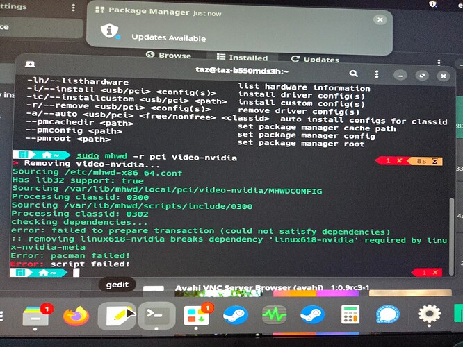

Here’s where I’m at so far. Should I remove linux-nvidia-meta?
I think you need to remove the package linux618-nvidia, probably the the one you mentioned as well.
I honestly can’t remember what I did. But there were 2 or 3 obvious packages I had to manually remove. Removed one, find the next one to remove, that kind of thing.
(For my Ampere gen Nvidia GPU, aka RTX 3080)
The mods usually frown upon screenshots..
``` Just type 3 backticks
— Paste contents —
``` And end in 3 backticks
(Or use the code block)
Yes. Remove that first:
sudo pacman -Rns linux-nvidia-meta
and then retry the mhwd command.

I apologize for the phone picture; only reason I used it is that I am not using desktop Firefox in this state. I have successfully removed the packages and am now installing video-nvidia-575xx. Will keep you posted on how it goes; it seems it’s taking a few minutes running all the builds.
Addendum: it’s done. Do I just restart my computer now?
Add. II: Just finished restarting! It worked! I have a functioning desktop again! I’m snapshotting and backing up immediately! Thank you all!
