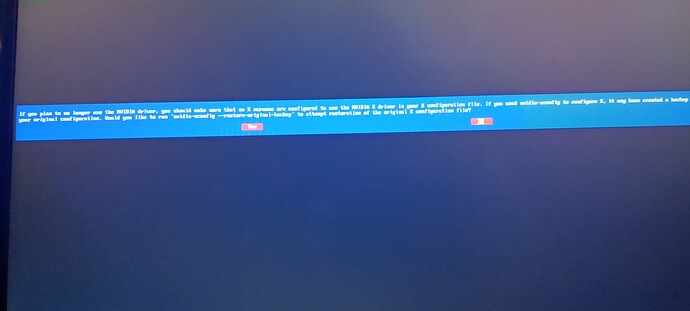

Ok I ran that and idk why is here so many Xs
It looks like its a prompt to ensure removing references to nvidia in Xorg configuration files.
I dont know if you made such changes, or what ‘backup’ it would be restoring.
You would probably want to delete any such configurations entirely.
I didn’t make any backup …
Didnt say you did … but the script talks about one and restoring it …
For more questions about the script you will need to ask nvidia themselves.
(we dont know much about it, dont support it, dont use it, and obviously it works great :wink:)
So I choose option yes or no???
‘Yes’ would make sense …
(but again I dont know what its ‘restoring’ if anything at all … likely any file it would be removing or restoring you would probably want to delete too)
