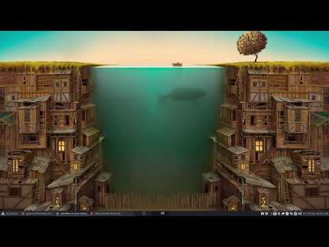

Found a vid on Youtube. This thing is awsome to say the least!
Well, that guy knows his way around linux ![]()
But beware that what was valid a couple years ago might not be today anymore. Make sure to check the comments on these videos. If in doubt, have a look at the github page, specifically the ‘issues’ section.

i think this is a good visualization of the process,in addition to what @wongs wrote:
