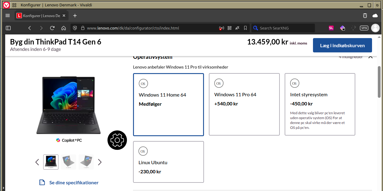

On the danish Lenovo page for T14 Gen 6 you can select Ubuntu - so yes it is designed for Linux

When I looked up the same system on the US web - there is no Linux option - I think that is an US thing - they don’t like opensource - they want capitalism.
